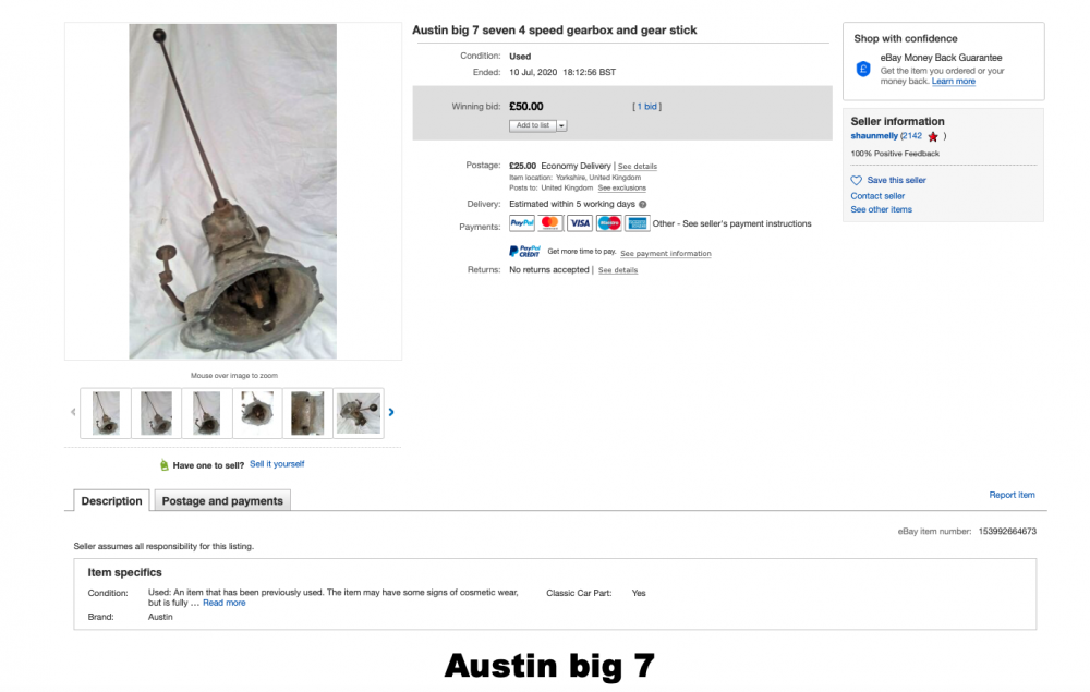

There was a Big 7 gearbox for sale on ebay within the past couple of weeks, but I can't seem to find it now. Regarding availability of gearbox spares, I'd suggest contacting:
Austin Big 7 Register and Austin Big 7 Spares (Robin Taylor) - email: robin.e.taylor@talktalk.net - send S.A.E for list of parts available.
Here's the Big 7 box I mentioned on eBay - it ended 10th July and is now apparently sold for £50 + £25 carriage - item number was 153992664673 - it might be worth contacting the seller just incase the 1 bidder has pulled out of the sale. He had other Big 7 parts, for example a water pump for £30, all now apparently sold.

I did see that Big7 gearbox on eBay, but didn't bid on it as the description is sparse, to say the least - no mention of whether it even rotated and in my experience when someone lists something as 'untested' that usually means 'checked and it's actually buggered, but I don't want to mention that...'. I was also suspicious that in the pictures it's obvious that the top cover has been removed and it's pictured with 1st gear engaged! I wouldn't be at all surprised if it was in the same state as my box....
