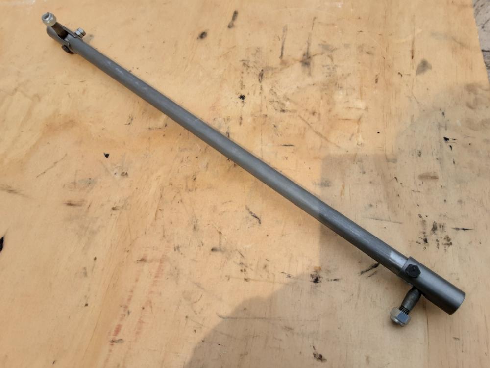

The drag link is made from cold drawn seamless tube. I have made new ones and even a left hand drive one by mistake.
  You can save an old one with a worn 1/4" hole by boring it up further and putting a top hat steel pellet in with the 'head' thickness machined to lock the cup in.
On the original set up the total lost motion is 0.030" to 0.090" which I find requires no improvement.
I have made a new one using seamless tubing from aircraft suppliers. They were able to supply concentric tubing which avoided the task of boring both ends. I do think the result removes a potential fatigue point in the bored out arrangement. I have not heard of cracks in this area but for me it was simpler to manufacture.
(13-03-2020, 01:47 AM)squeak Wrote: I have made a new one using seamless tubing from aircraft suppliers. They were able to supply concentric tubing which avoided the task of boring both ends. I do think the result removes a potential fatigue point in the bored out arrangement. I have not heard of cracks in this area but for me it was simpler to manufacture.
How was the inner tube fixed to the outer?
Charles
Charles I had a look and the inner tube abuts each inner ball joint cup and thus held in place by the through cross bolt.  The aircraft tubing is a perfect sliding fit and would take to a plug weld for belt and braces , I did not. Regards  Russell
It is 10 years since i had one apart and cannot remember. What stops the inner cup fretting on the bolt? Is it a tight fit and clamped by the tube distorting?

The correct bolt has no thread till it emerges and the cup is solid. The cup is a tight fit and difficult to remove, in an earlier thread someone described levering it out from the bolt hole with a small screwdriver.
To update this thread I found that making a new side tube kept on sliding down my to do list.
I then spotted that Tony Betts will sell you a whole new drag link - tube, cups, ball ends, caps for £75. Makes sourcing the the cold drawn tube, boring the ends and slots seem hard work compared to what I consider a very reasonable cost for a bolt on replacement.
Charles
It's an absolute bargain and well worth buying - you will most likely want to put the double locking nuts "down the way" at the steering column end though.
(29-05-2020, 09:54 AM)Ruairidh Dunford Wrote: It's an absolute bargain and well worth buying - you will most likely want to put the double locking nuts "down the way" at the steering column end though.
Just what I thought.
I like an engineering project but this is faster and simpler.
