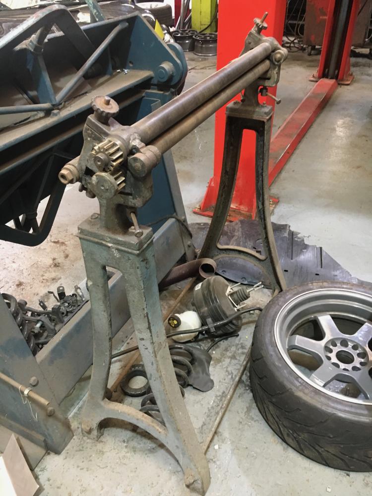

Hi David,
I can only agree with the advice given by Ian, Bill and Duncan. Make sure the wheel you buy is deep enough to take the panel width you intend, and allow for a bit of extra. Like Ian, my cheap wheel has a few flaws, specifically it needed shimming to take out some play, also, I had some problems with the anvils, which had flaws on the finished surface, this issue was sorted by the suppler Metz without any problems. Alas it did not come with a flat anvil, which would be a useful one for some tasks, such as starting a flange, which my car has in abundance! However, for the price it has done a fantastic job. I have managed without a shrinker, but sometimes wish I had one. As Ian says you can manage without, but, as with the wheel, they are labour and time savers.
My favourite tool is something I do not own, but is available to me in a friendly local work shop who never use it, I call it a pyramid roller; for making curved panels it is a fabulous tool, they think it is from the same period as my car too!

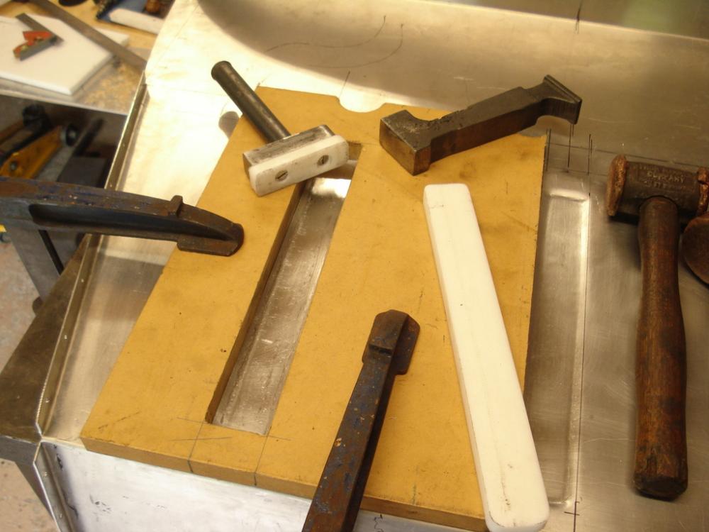

Thanks for the complementary comment Martin. I was looking at the photos of the van you are building, which looks great btw, and perhaps can offer some constructive suggestions for paneling them if you are intending to produce further examples. You could make a timber hammer form for the shape of the wheel arch, and other areas for that matter, this would allow you to easily turn the flange and stretch the metal around the curve without the need to cut tabs as it appears you have on this first one. I have found this technique extremely useful when producing all sorts of sections, added to which it is very repeatable, if you would like me to elaborate I can attempt to do so, here but demonstration is easier in a practical environment. ( Duncan! ) You can also do the same freehand with hammer and dolly, or a jenny, or even tip the edge on a wheeling machine, but a hammer form is so simple once you have made it and with your woodworking facilities I suggest easy to do.

The other thought for a one-off tail top is to hammer form the whole thing. In my particular case making a solid buck isn't a massive issue as I've a jumbo bandsaw and a cupboard full of sanders and some experience making similar sorts of things for vacuum forming curved ply and veneers. Perhaps in combination with a bit of shrinking round the edges (I bought the smallest size shrinker way back when) and some bat and bag.

I often use hammer forms for one off pieces, they are particularly useful when forming things like fire wall stiffening swages and such like. MDF is a good material to make them from as it is dense and stable the form will last for several pieces, particularly if working Aluminium. I do not use steel hammers that much when working Aluminium because it is soft and bruises easily, all the basic shaping is done with wooden tools and perhaps a few improvised from an bit of nylon bread board. Final planishing is usually done with a slapper rather than a panel hammer and this way I get good results. Steel panels being harder require steel tools, and than I would suggest investing in some good quality hammers, they are so much nicer to use than cheep poorly weighted tools. Kennedy in the UK used to do some nicely balanced hammers and dolly's that were not ridiculously expensive, don't know if they still do but worth checking out.
