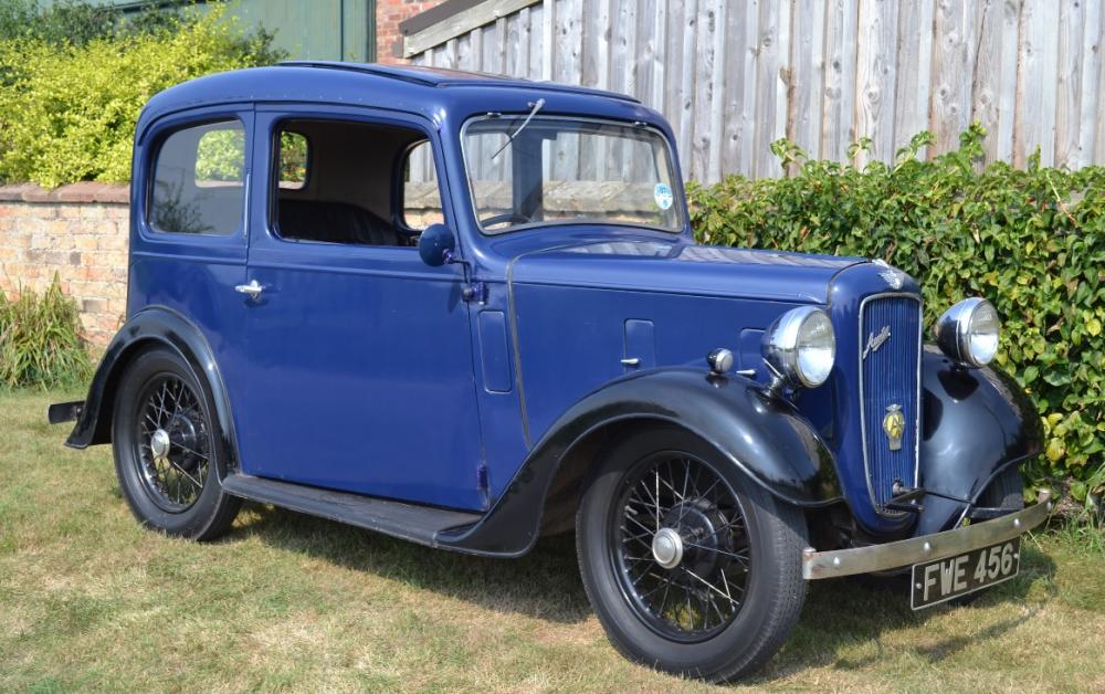

Update - Very Late Ruby up for Auction - Not Auction - More Pictures
My first Austin 7 in the mid 1970's was a very late Ruby, chassis number 290524, registered in January 1939, much later than this one. The car still exists and is still (I believe) the latest known saloon; there are later vans and possibly an Opal. The bodywork was standard mark 2 Ruby with a normal panel under the spare wheel, normal wing edges and normal scoop under the grille. It was original and tatty when I had it and had a normal amount of rust present everywhere. The late features were a plastic handbrake handle, Mazak radiator cap with a bar across it, slightly pressurised cooling system (water escape via a spring loaded valve), in addition to the steel sunshine roof, hidden hinge bonnet, rod brakes on the rear, metric wheel bearings and no registers on the wheels/drums. I owned the car for 5 years and did many miles in it.
I would suggest that the featured car has either been "customised" with P38 or a is a poor or misguided older restoration using the same material.
There were no modifications of this type to the body design by the factory.

Thanks for the information on the youngest Ruby - suggests this car has been modified by an owner.  However, there wasn't much sign of fibre-glass - must have been more a matter of cutting, fabricating and welding, though I didn't run a magnet along the long tail... Still wondering why so many small fiddly hardly-visible changes on one car.

Mike mine was / is ( FWE 442 ,now VXS 456) . I have a ledger entry from Sheffield archives showing about 50 Austin Sevens bearing FWE being registered on 31 /12/38 and 01/01/39
There are good pictures here of the Ruby FWE 456, Ch No. 290307 showing various very late Ruby features.  Note this is not a live auction.
https://www.handh.co.uk/auction/lot/340-...50919&sd=1#
Is the blue object on the choke pull due to a recent over restoration, or were plastic pegs introduced for 1939?

Looks like the ignition and lighting switch upgrade.
Was this fitted to the late rubies?
Or a later add on?
It is in keeping with the 'Blue' theme throughout...
(22-05-2021, 12:50 PM)Tiger Wrote: Looks like the ignition and lighting switch upgrade.
Or a later add on?
The ignition and lighting switch is a modern, south asian reproduction of the wrong type, intended for a car with a regulator. The original was probably a spade key type, 1-2-Side-Head (PLC2?) switch. My late Ruby had this replaced in the fifties with a FA keyed locking switch.
The ammeter is not original either.
As for the pan head self tappers.......
This thread reminds me of my first Ruby bought in 1963 in Cambridge for £5 if I remember rightly. It was registered FWE468 on 29th December 1938, which was 6 years to the day after the 1932 RP which preceded it. It seemed like a standard de luxe Ruby spec with steel sunroof and drip rails rather than gutters. I understand that it was one of 3 Rubies used as a Hire car by Marshalls (the Austin Distributor in Cambridge) during the war; another was FWE444 but I cannot recollect the other. Those cars had the standard body shape and square fronted running boards.
There doesn't seem to be anything strange about this car - so FWE 435 that has some odd features does not seem to be as it left the factory.
Having said that - is the apron below the cowl a different shape on the blue car - it looks a bit more horizontal - or is this just how it is fitted?
