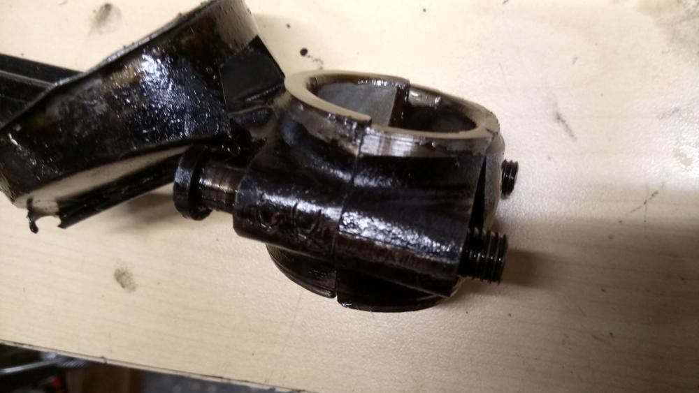

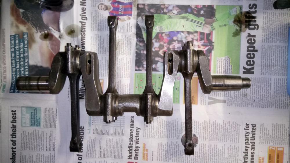

More evidence inside, bits of wire securing the big end nuts. One of them has a mangled split pin….
The Bodger managed to get this cap on the wrong way round. There was about 1/8” play in this big end, that explains the thumping noise then!

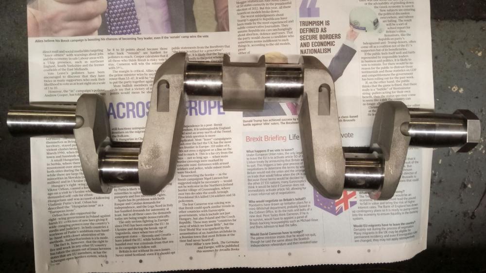

Everything in this engine carries the engine number 27998, except..........the crankshaft!
If that's an engine number, it dates to spring of 1924.
So the engine was rebuilt sometime in the late twenties I guess (the car came off the road in the summer of 1931) to change the crankshaft, probably for a second hand one. Again, I wonder why? Did the original break? I had always assumed that crankshaft breakage was a (relatively) recent complaint, due to poor maintenance and aged materials but maybe it was already happening a few years after the cars were made......
However, all the rods carry the 27998 number, so they ran on the original crank and there are no scars inside the crankcase to show a break. The metaling looks to be original....But why else would anyone want to replace a crankshaft??
I spent hours and hours sorting out the big ends. Two rods had to be replaced, number 4 because it was tired of running with the cap on back to front and was worn out, plus number 2 because it was heavily shimmed, having been filed too much by the Bodger. Fortunately, I have a small stock of good 1 1/8" rods to choose replacement from but the scraping takes a long time.....
I guess this is an early crank as it doesn't have any relieved spots to bash the main bearings out of the crankcase
Anyhow, I have to settle down to cleaning this lot over the next few days and sorting out the block...

I was going to run this engine with standard bores and 1 1/8” crank but chatting it over with some friends last weekend persuaded me to get the block cleaned up and re-bored. Having made that decision, I went for a poke about in the shed last weekend and look what I found!
I’ve had this Phoenix crank for more years than I can remember so now it’s time to use it.

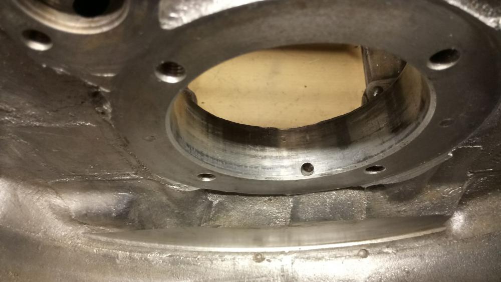

Now, fitting a 1 5/16” crank to a mag (or early coil) crankcase is straightforward but there are three modifications that need to be made.
1) A 7/32” drain hole is needed to return oil back to the sump from the main bearing.
2) The inside of the front lip has to be bevelled to allow room for the front of the crank
3) The camshaft centre roller bearing housing needs to be relieved to allow the larger crank to have clearance.
I made a tool for jobs 2 and 3 above, it’s a length of 1 1/8” bar with two old rear main roller bearings (early, 1 1/8” type) loctited on. These allow the bar to move through as needed. There are two holes for two pieces of tool steel; I use 5/16” silver steel, hardened and tempered. It’s only cutting aluminium. I guess I could add a cutter for relieving the front lip to fit a repair plate but I haven’t needed to yet.
All those have been done so now I can thoroughly clean the crankcase to remove all the swarf before assembly starts.
