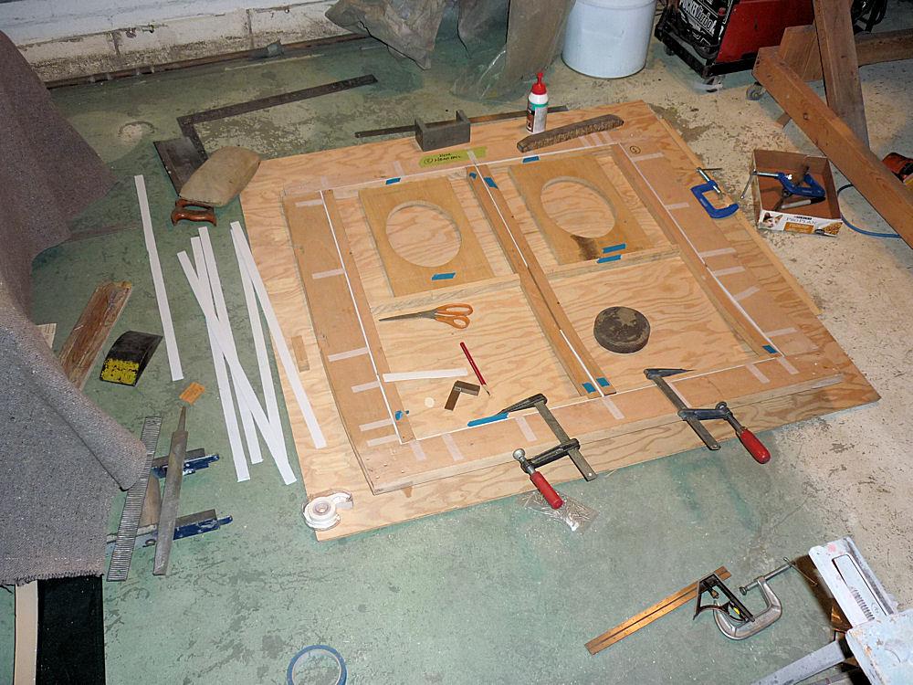

A long day yesterday spent assembling the rear doors using the rear frame to provide sizing. I had a lot of trouble trying to find 4MM material to act as the packing for clearance around and between the door frames. I discovered that corrugated plastic sheet was exactly 4MM thick so ended up using that which can be seen in the pics as the white strips between the door frames and the rear frame. One benefitĀ  of using this plastic is that the glue won't stick to it
Today I get to glue and screw the frames together which is a big step forward.
