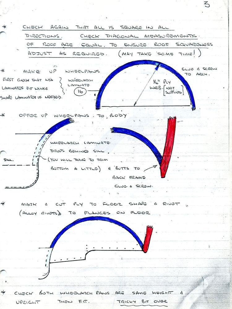

Peter: I'll am pretty much committed to making new arches. Seems to be the best option.
Henry : the rear wings are restored originals.
Stuart : John Heath's van kit uses wooden laminated arches :
So I'll try to keep with his original build method.
Thank you for the lovely pics.
