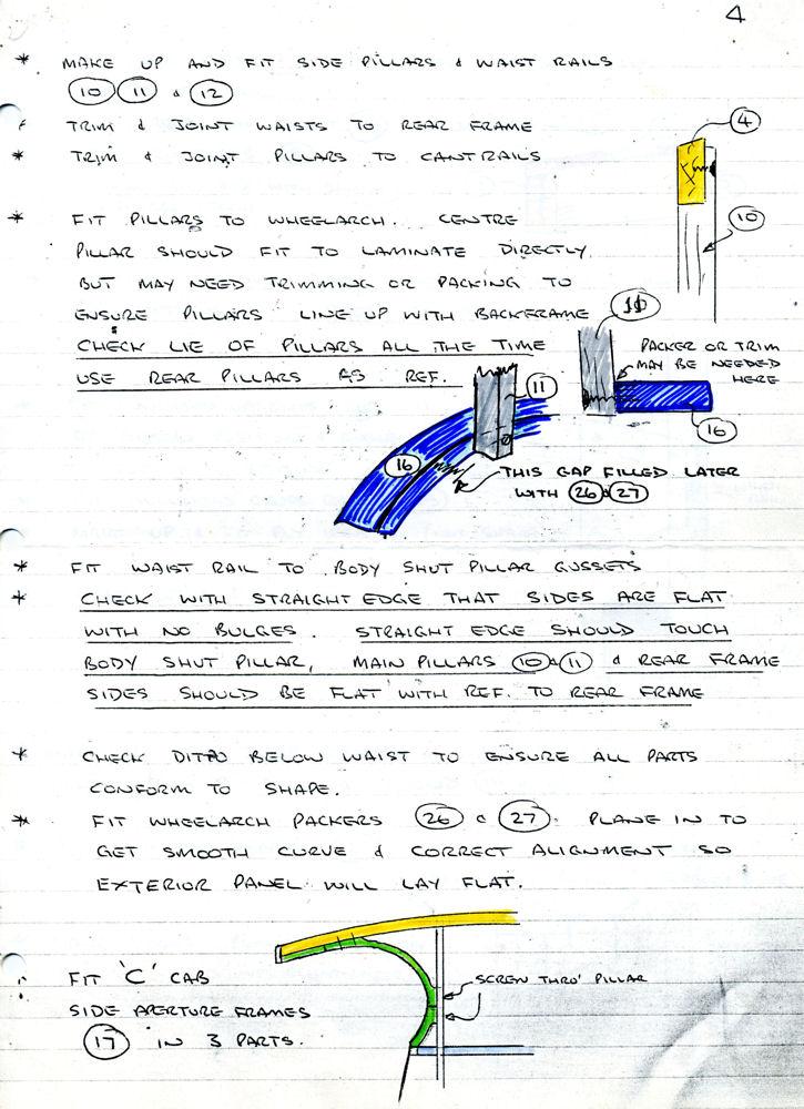

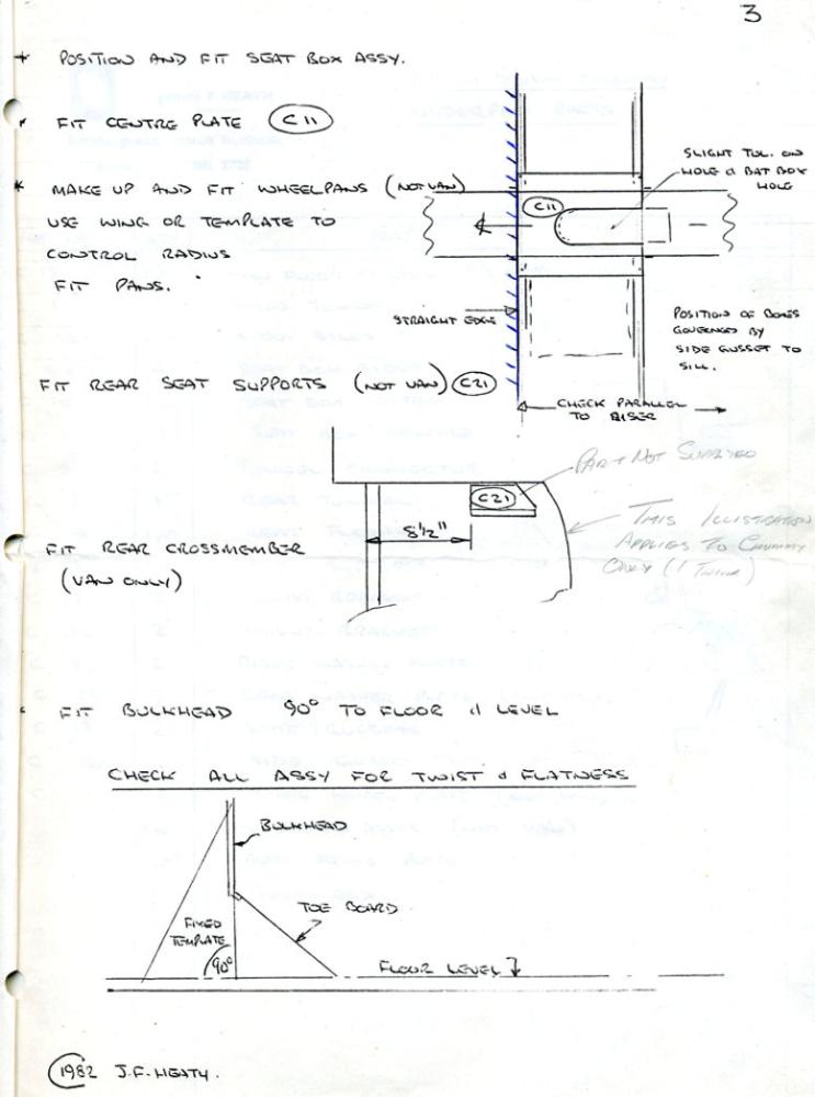

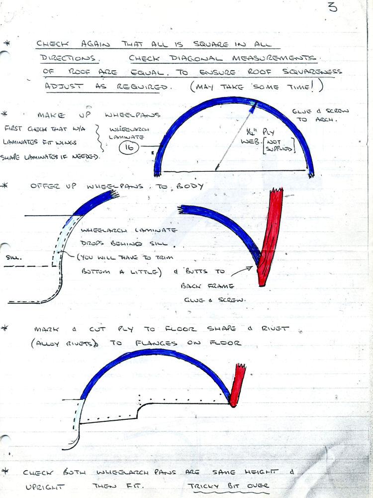

INSTRUCTIONS CONTINUED:
In case you were wondering I coloured some of the structural drawings to make things a little easier to understand.
Cheers,
Stephen
