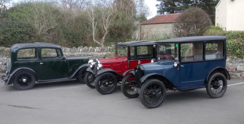

Here's the car, at the pub, meeting with some siblings for the first time ever.....
