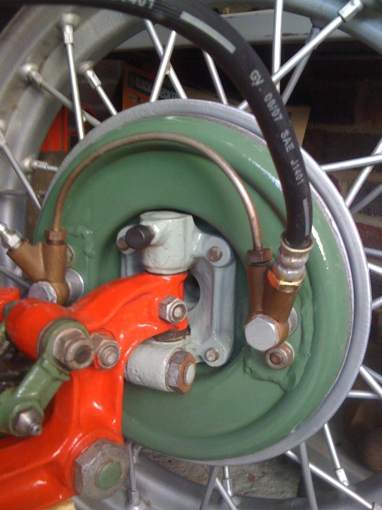

Here's a picture of my modified (late Ruby) front back plates - it uses early Morris Minor brake cylinders; its the twin leading shoe set-up -  Bill Williams Specials book also makes a reference to hydraulic brake conversion (pages c77 & 108/109);
