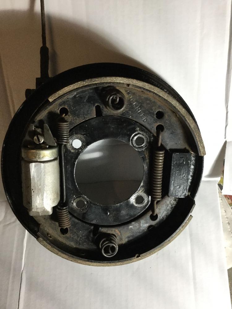

“Hi having read about attaching photos I thought I would have a go with pictures of th hydraulic back plate conversion on my 37 Ruby which may interest you.The conversion was done in the 60’s with Morris minor components .The back axle is off at the moment while I replace a half shaft and wait for warmer weather before venturing out to the garage for any time to put it back on.
As you can see it is what I assume is a Morris minor backplate welded to the A7 central attachment, the brakes are Lockheed.
