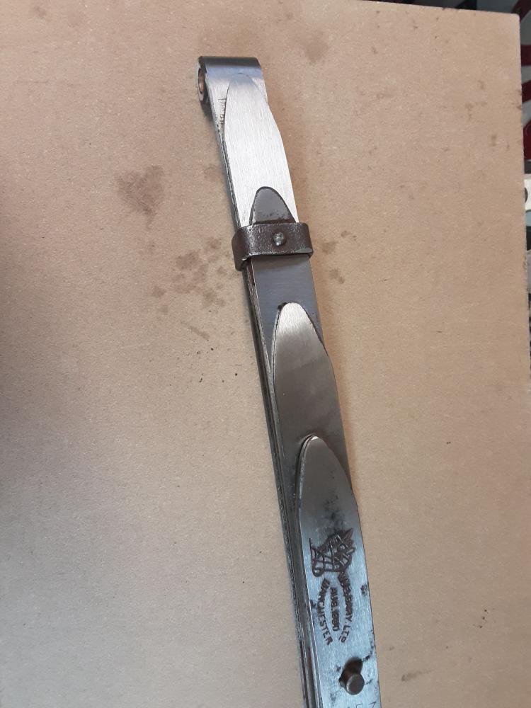

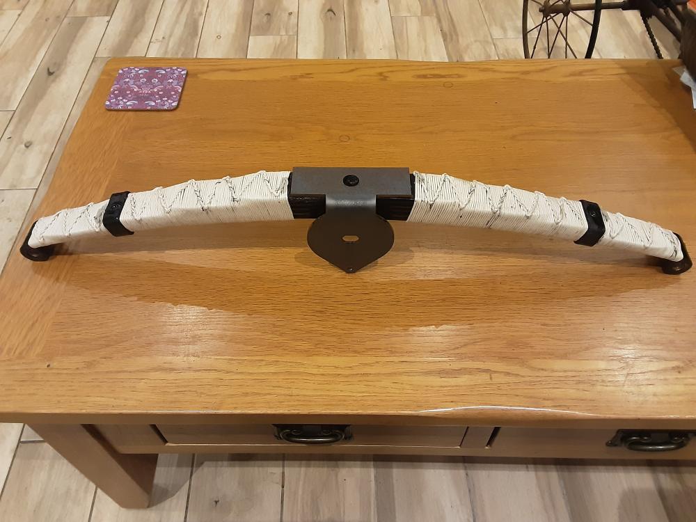

We looked at doing leather gathers for the springs.
But being new material, especially the belts. I'm just not happy with it.
So over the last week were I had an hour or two. I stepped the front spring.
Ground, or I should say with the belt linisher. I took the wear patches out of the springs were they rub together.
And once the paint was dry, I bound the front spring in the evenings.
Just a gater to round the middle now.
