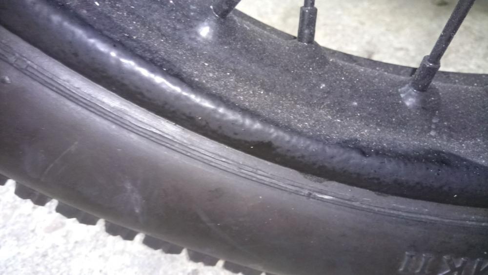

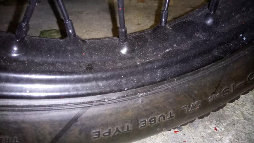

(19-12-2020, 11:40 PM)steve hoare Wrote: You mention different wheel rims. What are the originals?  I have a 1926 austin script wheel with the earlier rim as fitted to the 6" braked wheels which I assume is very early post 6" wheel.  Its good original though you might choose to re spoke it and has a tyre. Would exchange it for a later 28/9 wheel.
On my car, three wheels are like this:
And the two remaining are like this:
I think the first type rim was shared between the first "balloon" tyre, open centre wheels and the first closed centre, scripted wheels (March 1926 on). The second type was introduced sometime in 1927, Wyatt doesn't mention the rim change, neither does Purves.
My car was manufactured December 1926, so the three earlier type wheels are probably original. I think two wheels were changed on this car due to the accident.
