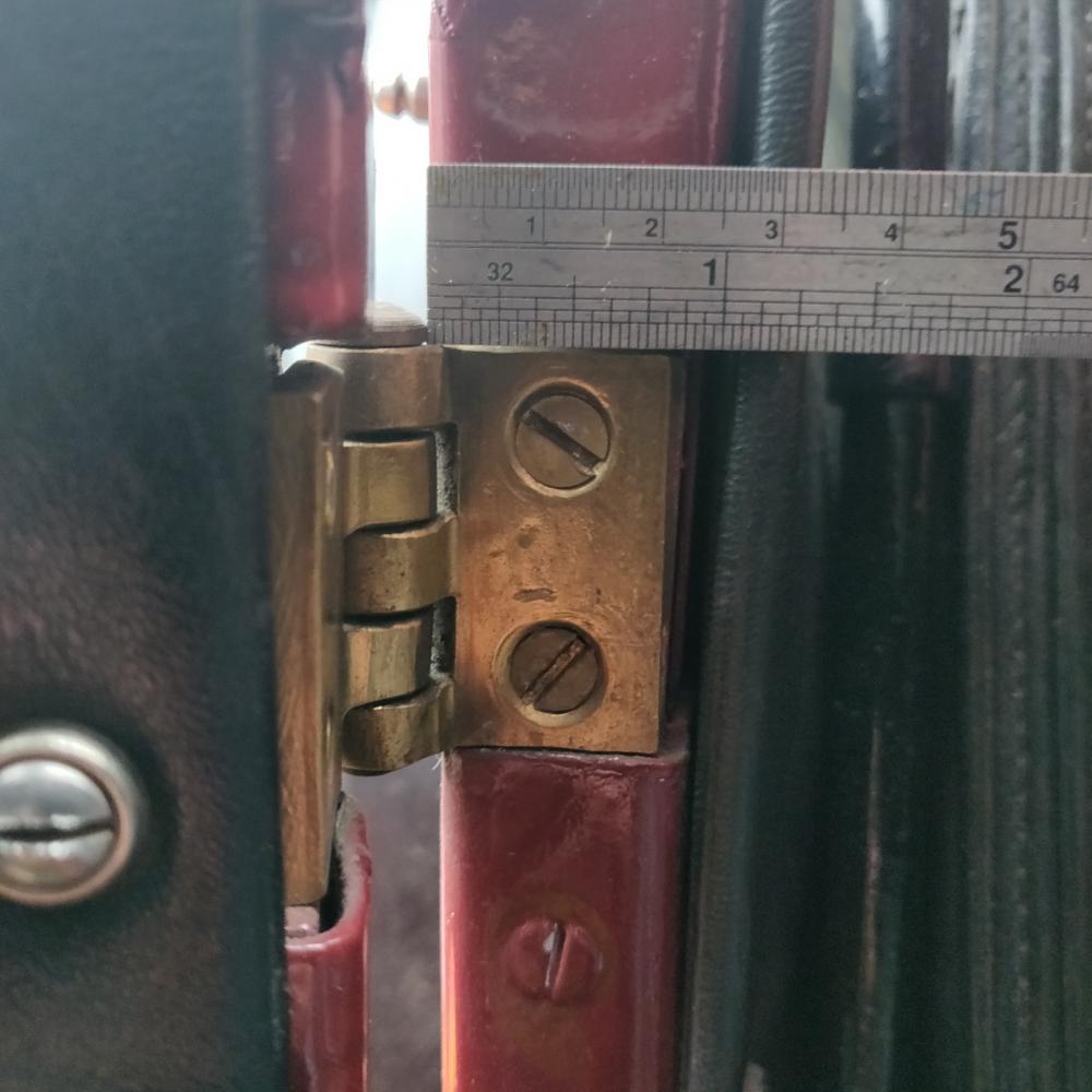

Chris, as promised.
Photos are of my 65, chassis number 193400, 17th April 1934
Door hinges:
Lower hinge distance from hinge pin to hole centres 1 1/8"
Upper hinge ditto 5/8"
Height of hinges 1 1/2"
