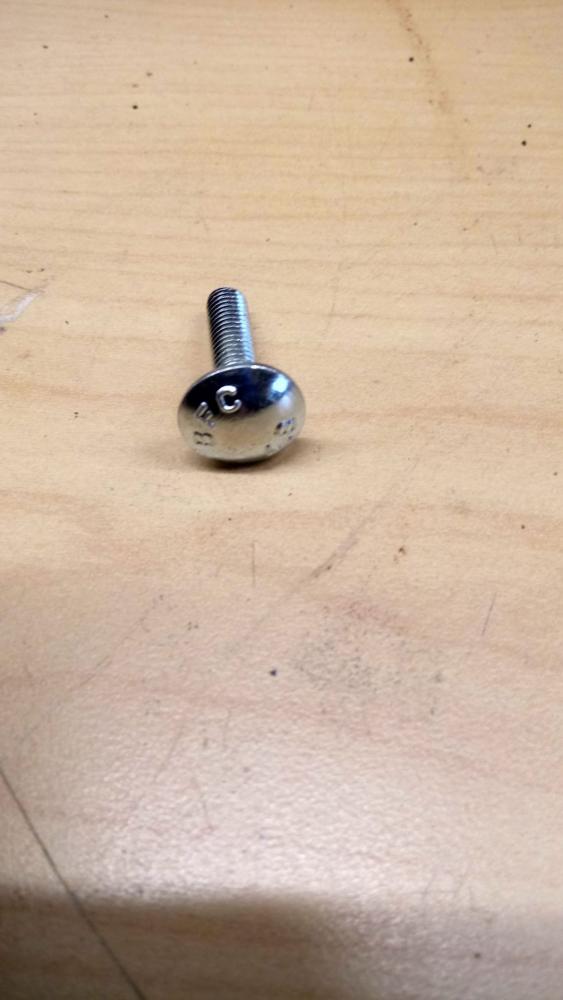

Vintage Sevens (including Box Saloons and derivatives I seem to remember) have the front wings held on with coach bolts. On the Top Hat, these were the originals and were 3/16" dia, BSF threaded, which are unobtanium. The closest available is 5mm (3/16" is 4.76mm) but it's impossible to buy plain steel ones, suitable for paint; they all come BZP or sometimes blackened and often with printing, like this:
 However, it's possible to deal with the BZP finish, here's how:
Step 1, Deal with any surface printing. These are quite soft so a file will do the job. I also reduced the height of the square bit under the head.

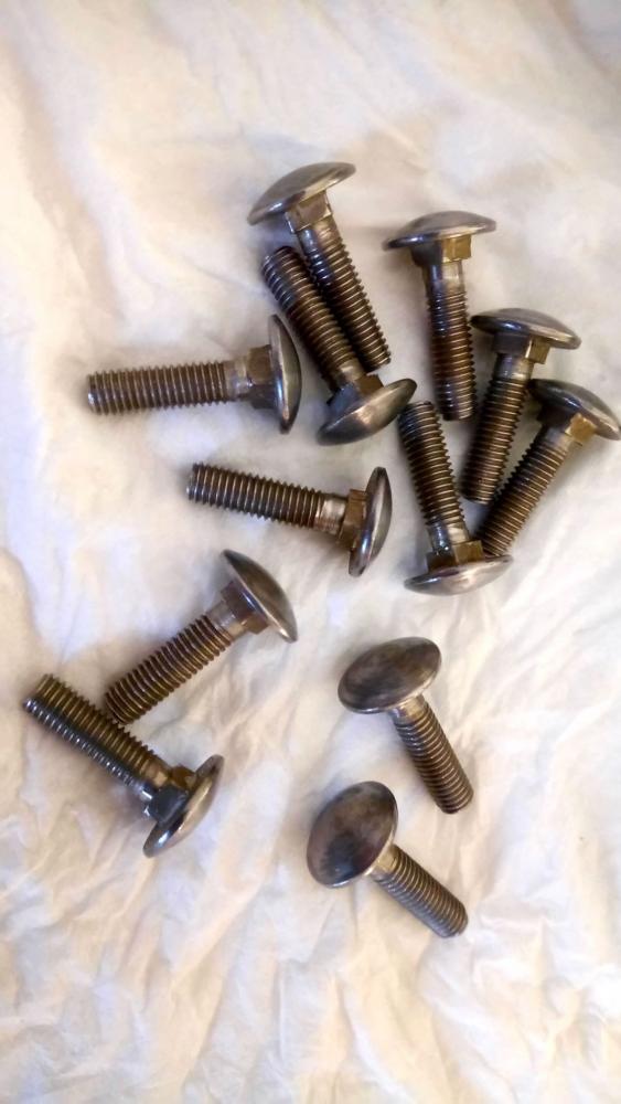

Step 2 Mix some citric acid crystals (I used about 2 tbsp in a small jar) with hot water to dissolve them. Then pickle them for 1/2 hour or until they stop "fizzing" completely.
Step 3 Wash with plenty of cold, clean water but beware, they will rust easily! Now you have plain steel bolts, all ready for etch primer...
