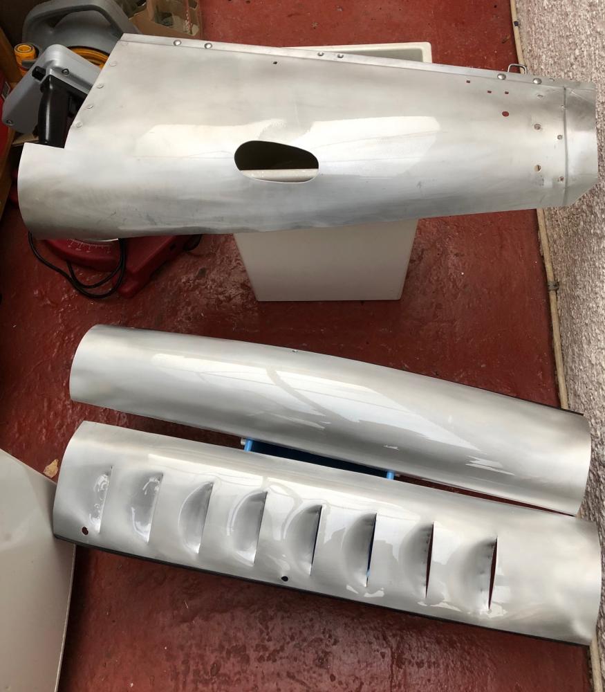

    Decided to have a change from all things bulkhead and wiring related so
went back to metal panel finishing and lacquering.
So rubbed down some of the panel beating  and welding marks on
the front wings, both undersills and the drivers side flitch plate.
Then finished with two grades of Scotchbrite pads on my large angle grinder
fitted with a Velcro rubber disc.
This leaves the metal surfaces covered in fine blackish dust so
headed for the family bathroom to wash the sills and flitch plate
Down with some Fairy liquid and loads of hot water.
Throughly rinsed and then dried off with clean paper towels.
Then washed down with Meths and dried off again with clean paper towels.
Moved all the bits to the back porch( garage is too cold for spraying)
And sprayed on the Nyalic in about 2 minutes! Will give it a second coat
Later tonight.
Finish is excellent. Hope it lasts!!
