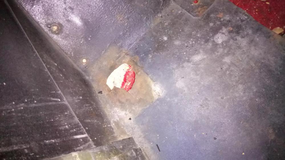

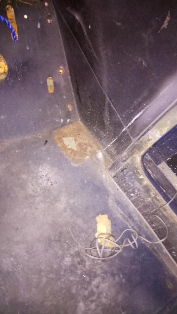

In the meantime, it seems I will be busy repairing the stress cracks and holes in the floor. Someone has had a go at welding the cracks up in the past but it needs to be done properly now.

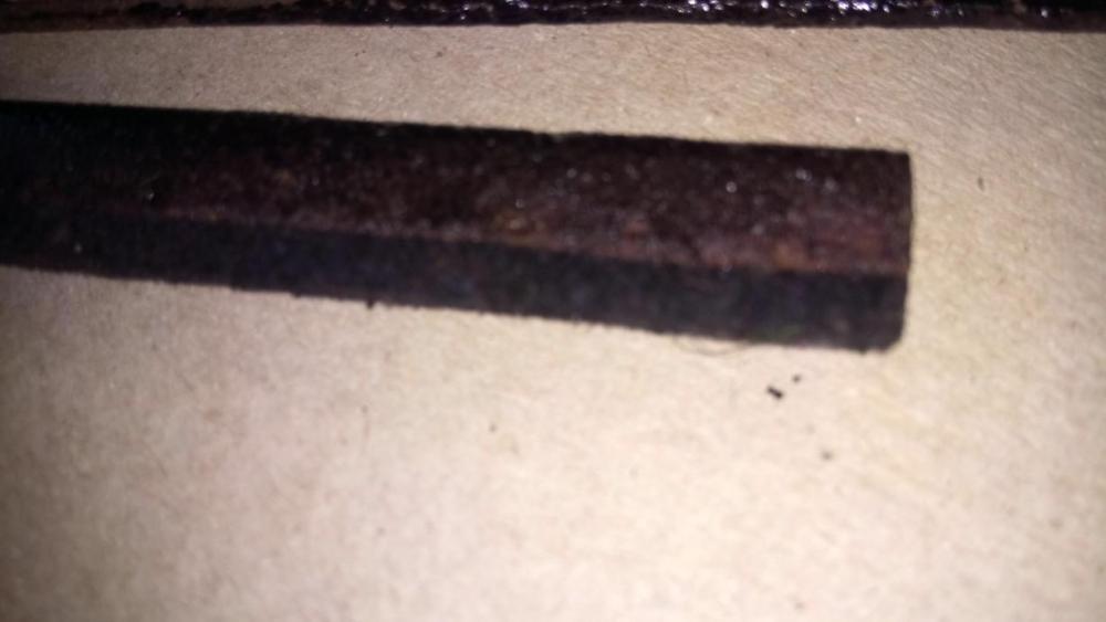

BTW, I dismantled the (presumably) original wiper arm and blade this weekend. The wiper blade is made of felt! Is this right? anyone else seen this??
