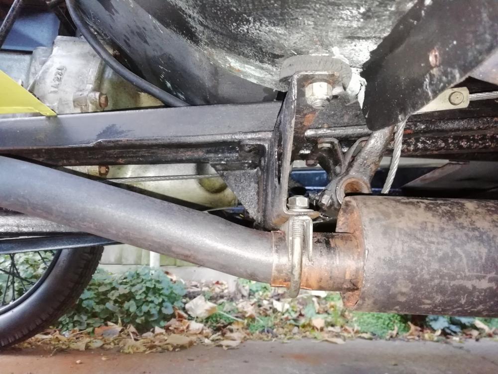

This was the result of LWB front pipe (cut down), sidedraft manifold and resultant position on rest of SWB car. The rear mount bracket is a mini one - 4 quid delivered from ebay. It's a bit lower than the "thru' the chassis member" route, but at least there is a bit more clearance from brake cables and battery box.
Can I assume that connecting a cut down LWB front pipe to a updraft manifold is a complete no no?
