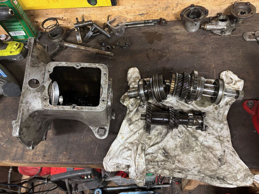

With some guidance from the helpful article on the Cornwall Austin 7 Club website, I had the gearbox stripped down with relative ease (not withstanding the evening when I'd misread the instructions as I was trying to do this at 11:30pm after a busy day!).

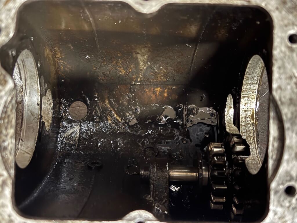

Inside the case looked even more dirty and I seem to also have a collection of spring washers! I wonder when those were lost, a while ago I bet as some were buried under the dirt, not just sat on top.

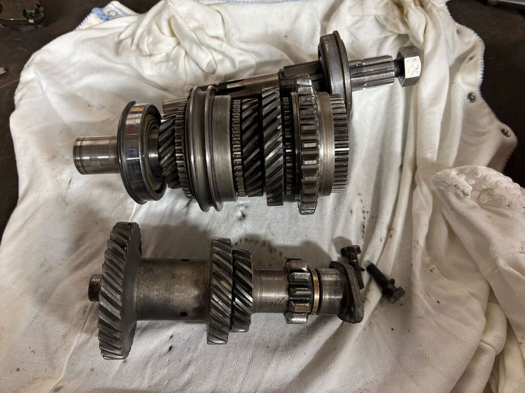

The gearset looked equally grim, though after a bath and a scrub was looking much better for itself. I think that layer of old caked on dirt and oil had actually protected all the steel parts from the water and there was really no corrosion to be seen anywhere inside the gearbox, which was a huge relief. I'm not hugely experienced with assessing synchros, but they didn't appear to be bottoming out, and there was no sign of rocking when the two tapered pieces were held together, so I believe that's all looking promising!

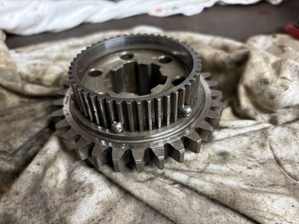

While cleaning I made the mistake of pushing down a bit hard on the 1-2 sychro assembly, and it popped apart, with 6 spring loaded ball bearings flying across the shed in opposite directions! I found 5 of them, but the 6th was nowhere to be seen. Helpfully they appear to be standard 1/4" ball bearings and I had a plenty of those left over from overhauling my BSA, and some with some fiddling and help from a jubilee clip, I was able to get it put back together!

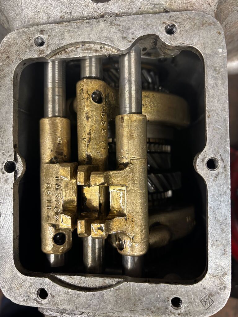

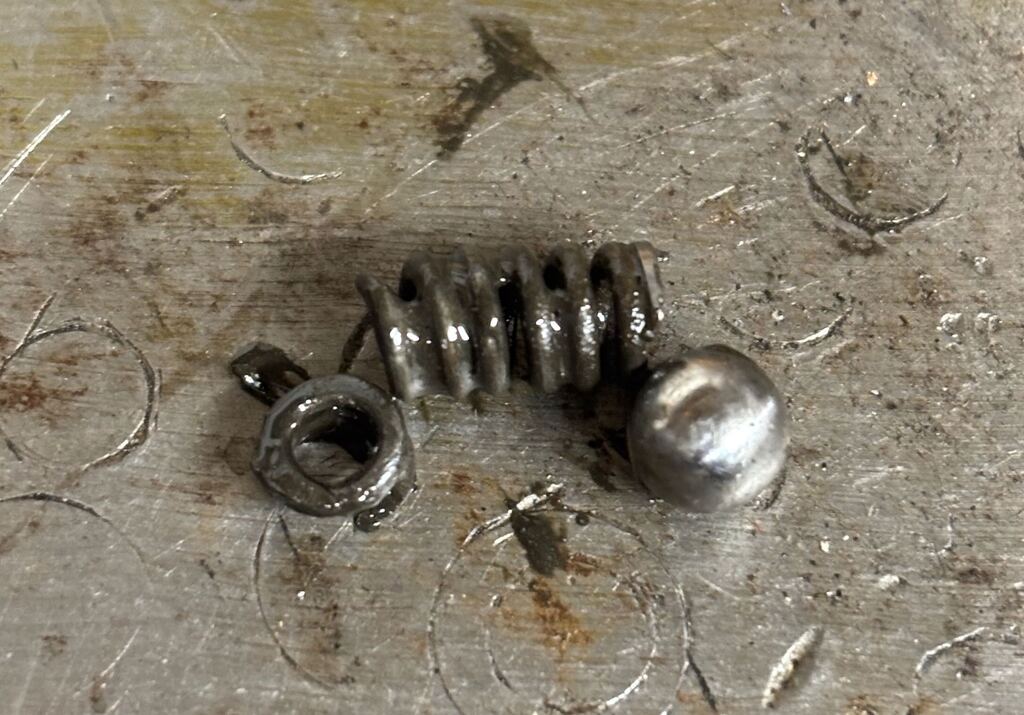

I also discovered a broken detent spring, on the 3-4 shift fork. Due to the sideways load applied by the helical cut gears, this would have likely had the car popping out of 3rd, which I believe is not unheard of with these boxes. I fitted new detent spring and balls to all 3 shift forks as a precaution.
