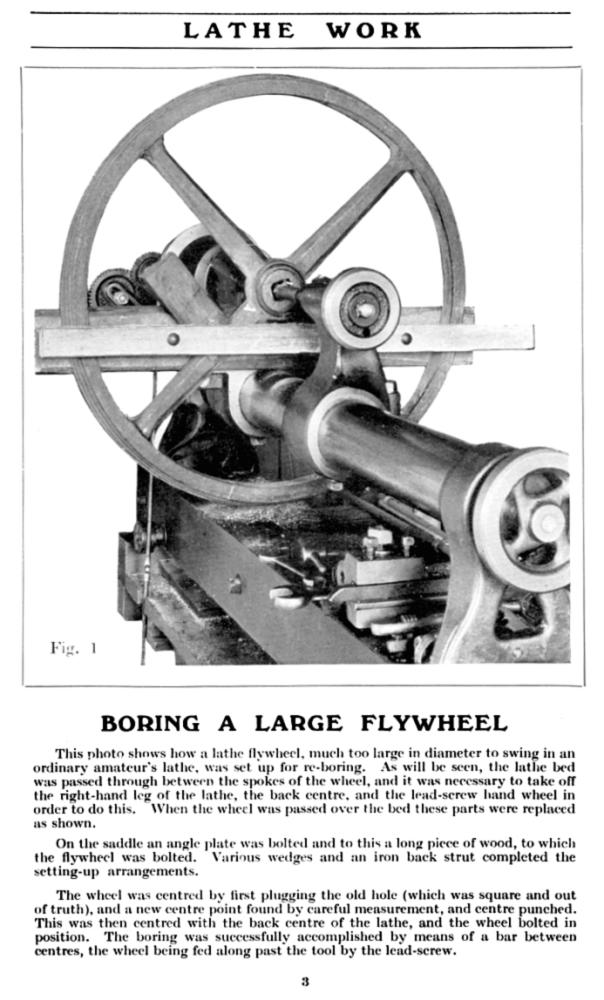

Using an older, worn-out lathe originally sold at the bottom of the market in the early years of the 20th century might seem a crazy thing to do - and it is when so much better machines are about. It is surprising though what could be achieved on one of the most difficult-to-use lathes ever made, the 4-inch centre height Round Bed Drummond. Here are a few of the things built on one:
