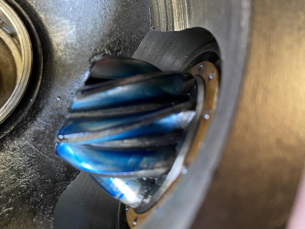

Apologies for the delayed follow up, I didn't get chance to work on it the weekend before last but I think I have made some good progress this weekend.
Dickie - sorry I have only just seen your reply, I understand what you mean about the blue. I was just keen to make sure I achieved a visible impression with it so I could see what was going on.
The pictures below show the most recent mesh pattern. I have set the backlash to within spec as per the first pattern test, the only tangible change I have made is to increase the pinion shim size from the original 15 thou to 25 thou. I am a lot happier with this pattern now, as it has moved off the very edge of the teeth and it is contacting more along the length of the teeth.
I'd be interested to know your thoughts.
Thanks
Matthew
