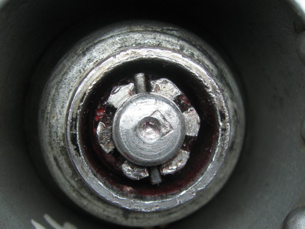

You can replace the split pin with a roll pin (see photo) much easier to fit and remove. Terry.
