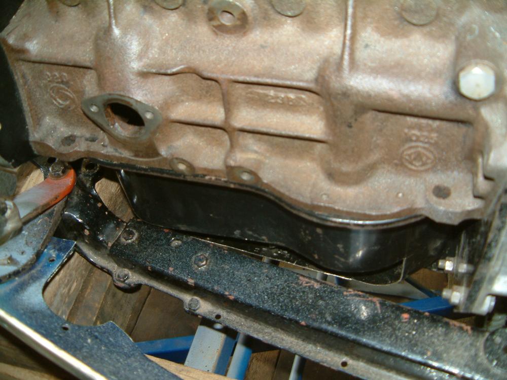

Sump close to chassis after moving engine slightly to nearside to make room for clutch slave on
 offside

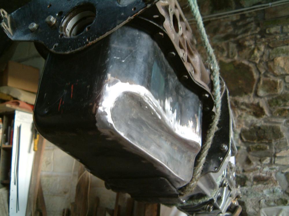

Sump a bit modified to help clear chassis

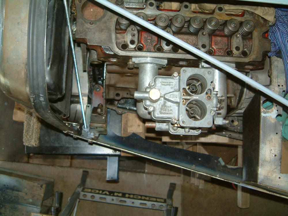

Clutch master cyl on top of bulkhead...brake master fits next to and outboard.

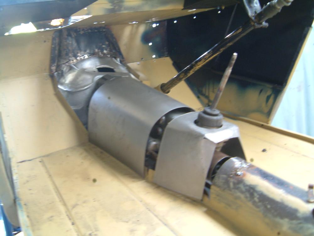

Floor gearbox cover beginning.
Completed

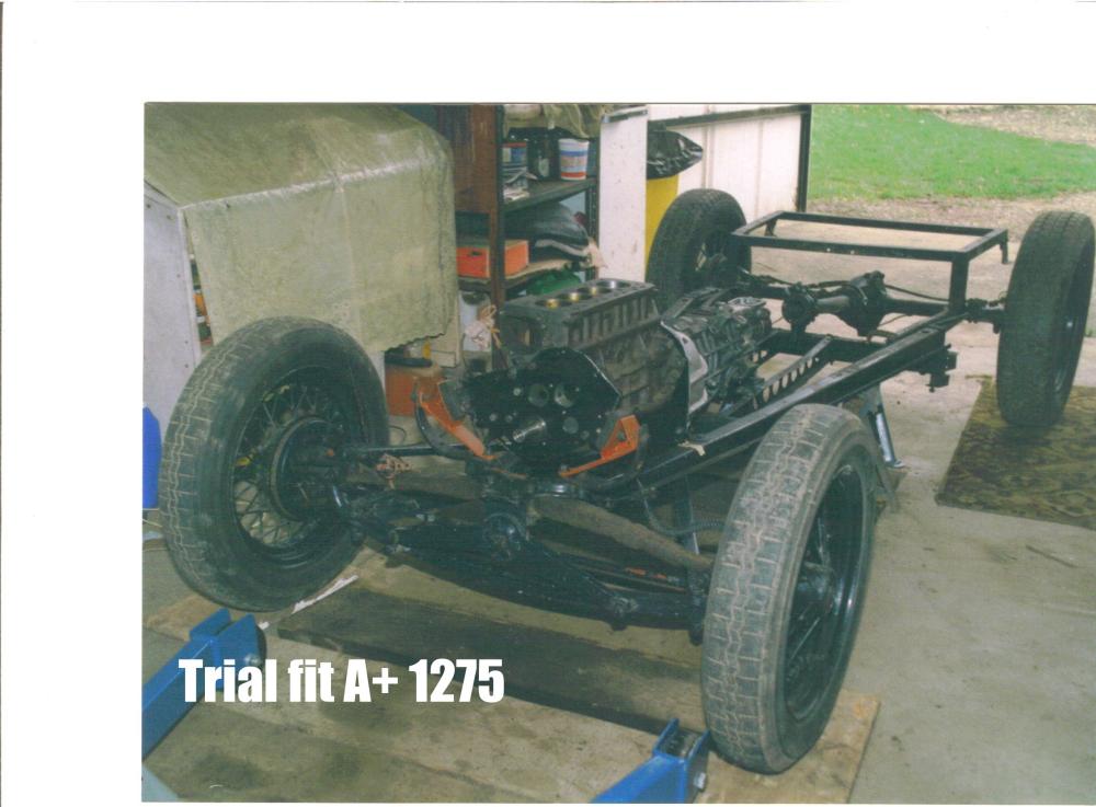

PDavies ..thanks for the pics.  My set up is likely to be quite different.
Plenty of room for the Webber but its filter might need a slight bulge in the bonnet.
