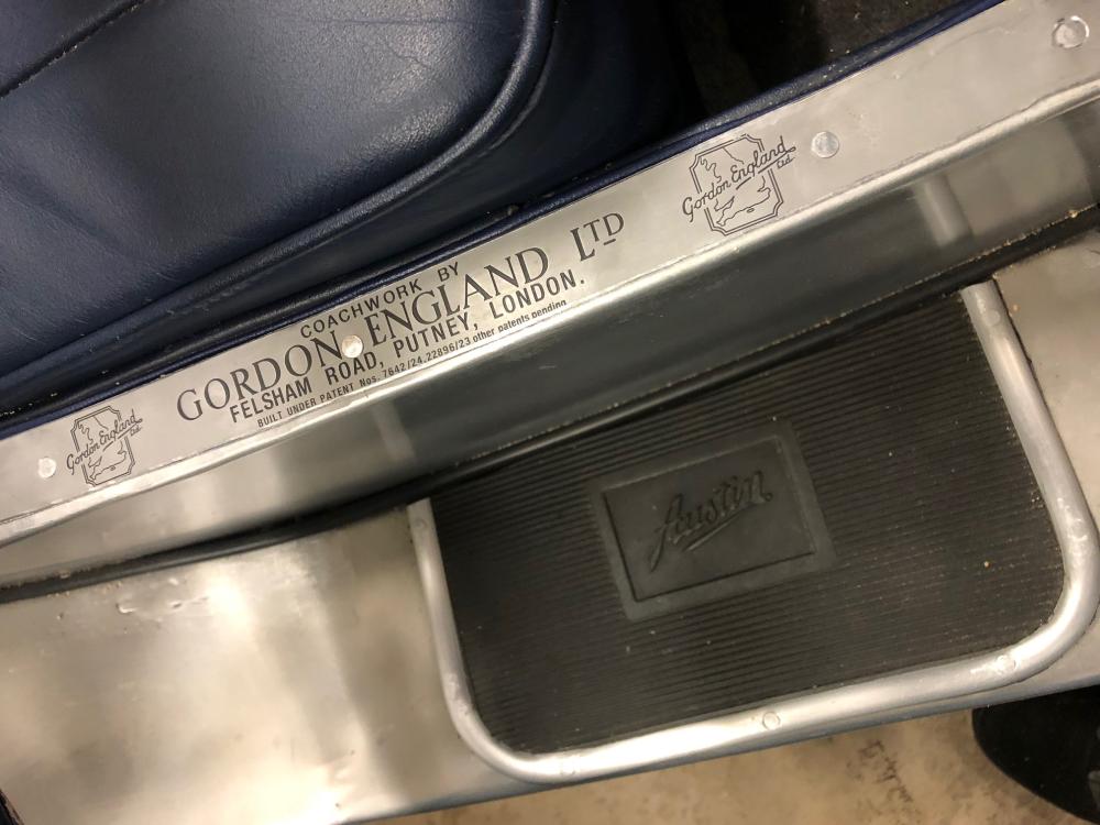

Fitted the GE threshold plates kindly donated by Ruairidh, using tiny countersunk flat headed alloy rivets
Tapped and glued into the sill. Also refitted the unique , nickel plated bronze GE door slams and nifty little door catches. One not quit fitting clear enough for the bolt to “shoot”. Try again tomorrow.

Here are some photos to show the Threshold plates that came from Ruairidh, plus the home kit renickelled catches

Ps door slams now working!

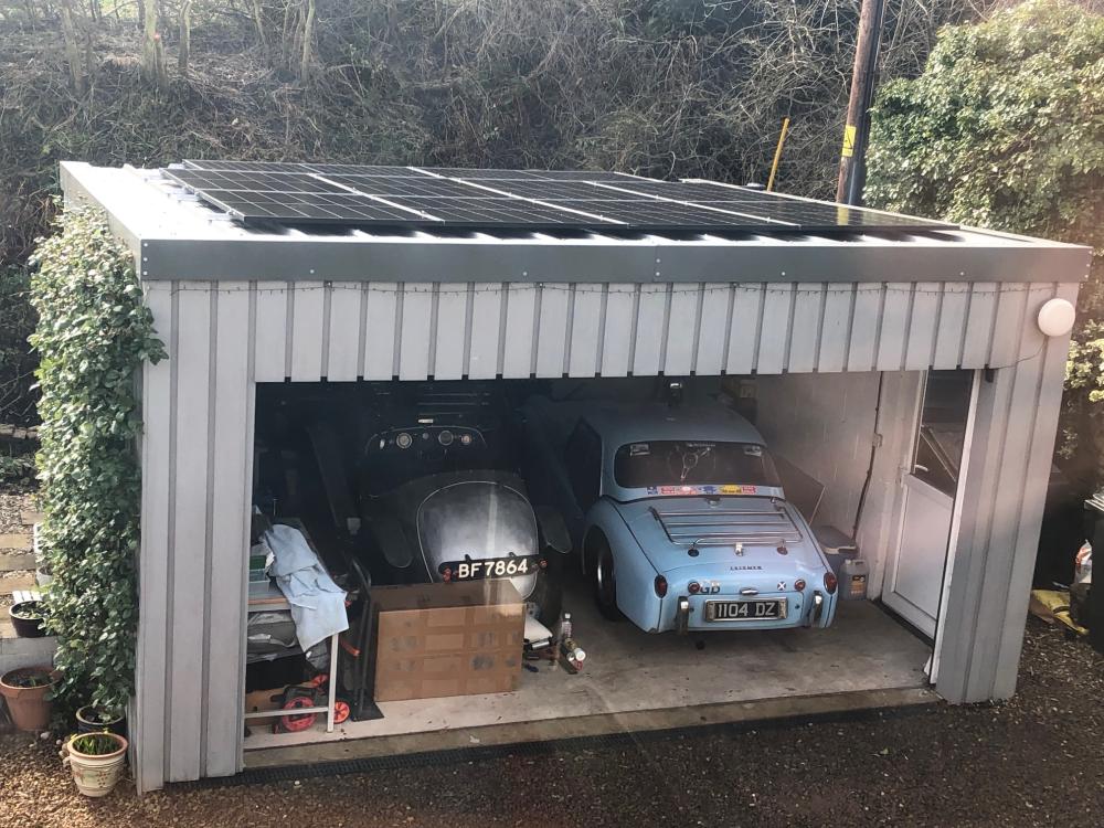

Big day at the AllAlloyCup garage. After a 6 month supply chain issue the new 10 x 400w panel solar system is being installed on top of the south facing sloping garage roof along with a 10 kWh battery. Once the TR3A goes will an EV sit alongside the Cup I wonder? Has anyone built an A7 EV yet ?

The solar system built in 2 days! 10 x 400 w panels with a 10kwh battery . Can function as emergency PS should the grid go down. We had a 3 day power cut last year.
Excellent! Well done that man.
