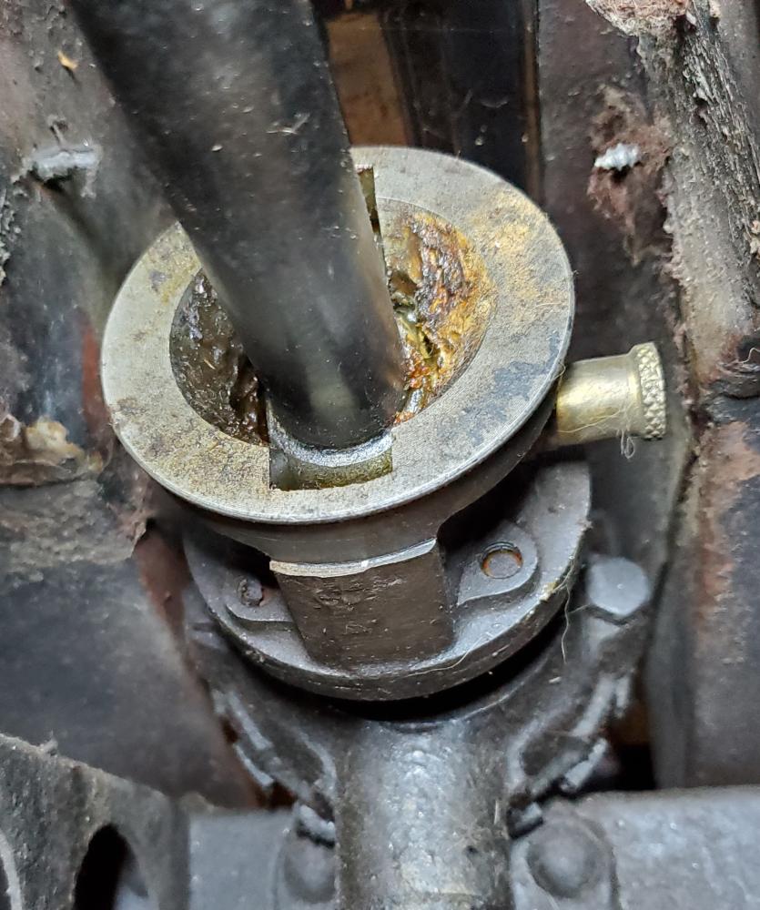

Another problem has popped up. I am trying to remove the ball from the extension on the torque tube pivot. No go. Is the cylinder inside the extension supposed to pop out?  Photo attached.
Yes- - sometimes tight but you should be able to lever it out.
I'll try harder.  Thanks for the reply.    Arnie

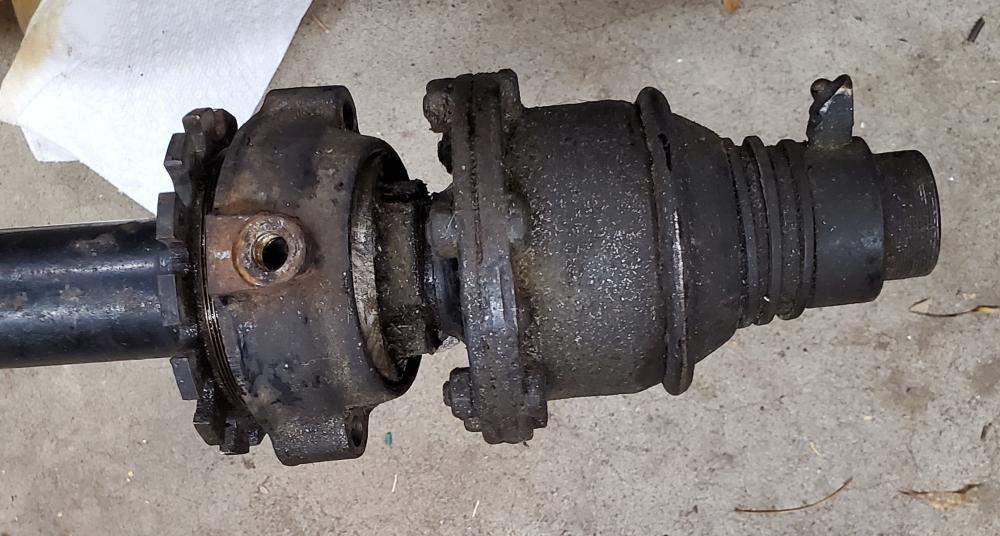

New problem has cropped up. My torque tube universal joints are obviously different. I am thinking the existing joint will have to replace the joint on my replacement rearend. Is this possible or what should I be doing?  Sorry to keep bothering everyone.  Regards:  Arnie
Dunno what model you have but there was a change from a pot type universal as top photo to a more conventional universal as below (except it has plain bushes not needle rollers) around 1933. The drive shafts differ. Dunno if  flange on the diff the same; others will advise. Looks different. It and the universal can be changed but some care is necessary.
The later universal should have barely detectable lost motion in the innards. Long lived when well greased but many not.....I am curious that the ball joint is not adjusted up. This, and many other checks are conveniently explored before assembly.
