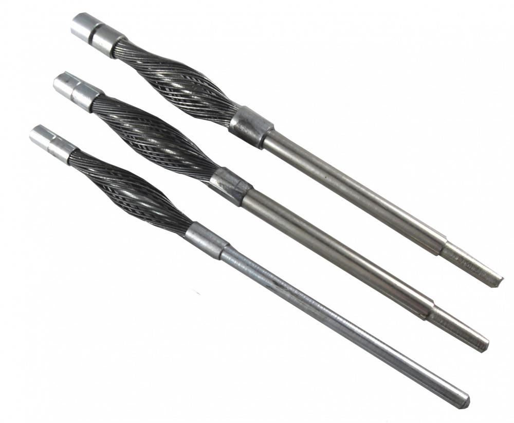

With the head off I would be tempted to whip out the valves and run a valve guide cleaner down each one, I imagine they might be nipping up once the engine starts to get hot.
