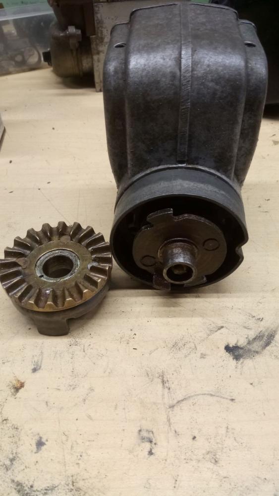

I have one magneto with the "Flick" drive, otherwise known as an "Impulse Starter". Unfortunately, it has a drive flange with 20 teeth on it intead of the 19 we require,
so will take some re-engineering to use. The Flick drive operates at speeds below 250 RPM where it retards the magneto and then spins it quickly over the point that the spark
is timed, helping to start the engine. Maybe I'll try and incorporate that on the Mag for the Top Hat if I have time

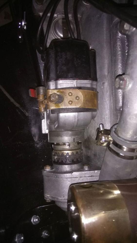

Here's the finished product, ready to fit.
Whilst I'm rebuilding SR4's, I must have a look at the one fitted to my Chummy, which has been operating for a few years now and needs the bearings greasing.

Surely the right drive flange can be found, no? I'm sure I saw that somewhere.
Compete Automobilist (Paul Beck) or whatever they're called this week were selling the 19 tooth flanges, I have one. It needs machining and fitting........

Having got the shower under control, I thought I'd have a go at the Top Hat on my last free day. I rebuilt the magneto again, this time putting the impulse (Flick) drive onto the front of it, timed and fitted it, filled up with petrol, oil, water and pressed the button hopefully. I was rewarded with a running engine! I spent half an hour zooming up and down the drive; at the end of that time, the engine was running nice and smoothly, no nasty noises, clutch works, 1st and reverse work, speedometer works and so does the wiper motor!
