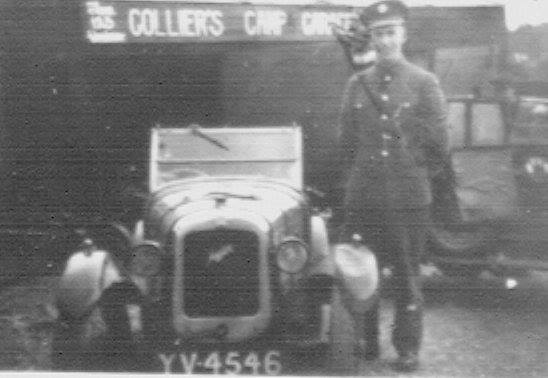

Bill, please reposition the Austin script so that the 't' is vertical; somehow as you have it really irritates me  Big Grin
[Image: 14_13_12_17_12_38_28.jpeg]
Hi Mike, Funnily enough you must telepathic !!!
I stuck it on temporarily and meant to check how it was positioned
In period photos and was actually doing that, just before I opened
Your unhappy response!!!
From looking at the period photos on Ruairidh’s GE
Site I can see that it needs to go at a more jaunty angle
and line up with the Head lamps( Which I cant fit as the rad shell
Is still at the platers. So I promise to put it all right for you....
