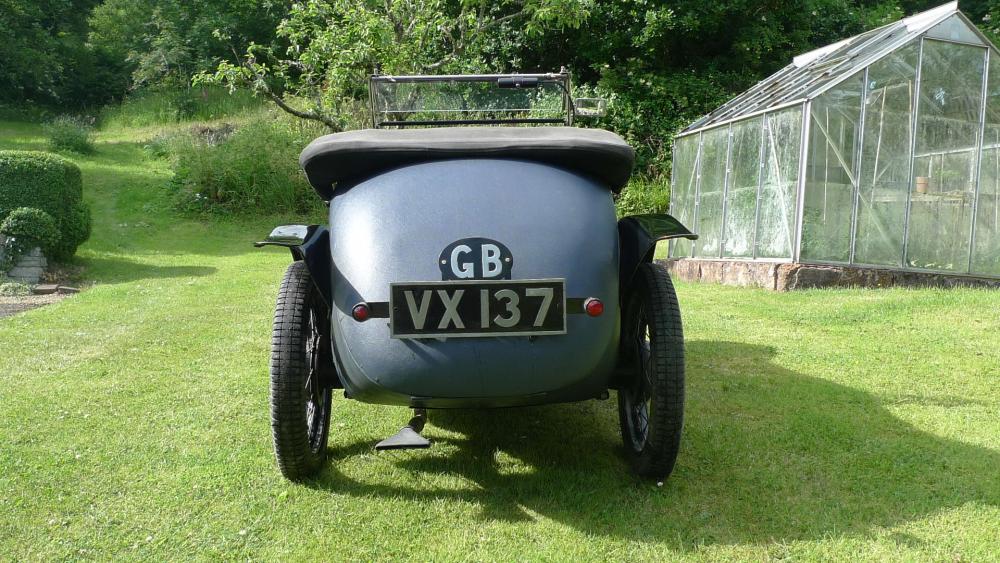

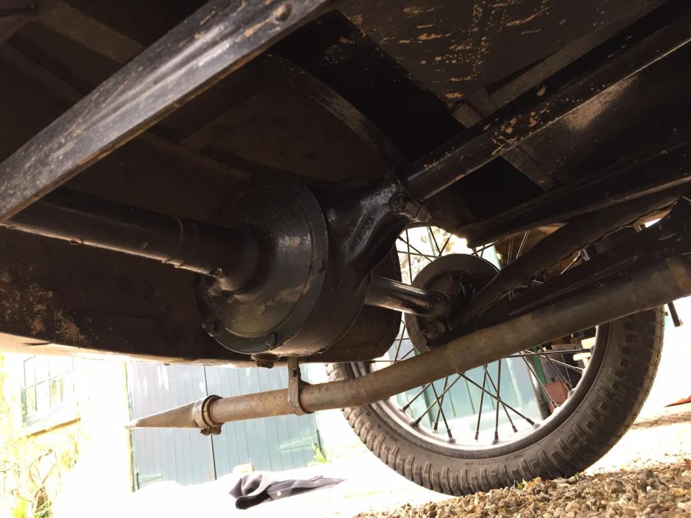

(09-03-2019, 11:41 PM)Ruairidh Dunford Wrote: Tom Coates, this Cup is also on lowered springs...I was just thinking that! Bill, I think your problem is the combination of a late exhaust manifold which comes down a bit further and a new front pipe. I have an original one and it runs over the hoop but with a bit of a kink behind it to drop down and line up with the silencer. I also have problems with my front brake cables rubbing on the bottom of the hoop (even with normal height springs, but yours look ok. My tail pipe tucks inboard of the shock absorbers and runs below the axle with a slight bend below it. I've fitted an aly fish tail and it works quite well. I am going to send Tom's plans to Andrew Goodfellow when I'm done.

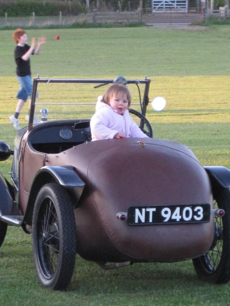

Will stick with the standard short tail pipe first and see where that takes me. The brown Cup shown above has suffered a bit of body damage due to the lowered road height so do be prepared for similar.

And what diameter tail pipe, as that looks bigger than the one on my 32' RN
10-03-2019, 06:12 PM
![]() Dear Tom Thanks for the pictures of your very tidy rear end! If I was starting from scratch I’d follow your front routing through the hoop, but thought I’d have a go with the pipe That came with one chassis. What exactly does a fishtail do? Does it quieten the exhaust? I know Tom A has one on one of his Cups and they were obligatory at Brooklands. My pipe diameter is 35mm OD so not standard at all. I’m still messing about with pedal clearances, but will have to remake the drivers side toe board to suit the new pedal positions. Keen to sort out all underbonnet and front wiring in Anticipation of the newly plated rad shell coming in a week or two. The bonnet is completely finished and lacquered and ready to fit. The CAV headlamp stalks will need some wedged washers to get the lamps to point forward instead of cross eyed! I may have to rethink the exhaust pipe routing as Neil pointed out that I may not be able to make enough clearance between the pipe and flitch plate at the point the pipe goes under the hoop.... Will keep you posted. Hope you too can get to Guildtown. Kind regards Bill G

Bill, the fish tail I think is supposed to keep the noise down but I'm not sure if it makes much difference, its mainly there because I think it looks nice. My pipe is 1 1/2 diameter so not very standard either. The elegant lines of a Cup come at a price as there's very little space around the engine compared to factory models which makes working on them a real pain. Mine has a tubular exhaust manifold with the flange under the passenger toe board which means that you have to take the exhaust studs out completely to get it off and you also need double jointed fingers to do the bolts up. I have added a little hatch through the side valence to get at the updraft carburettor without burning my arms on the exhaust. Its all ok if your car doesn't need to be adjusted or come apart too often!
