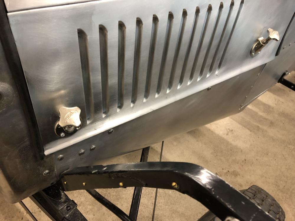

To gain an extra 1mph top speed I have followed this design
feature to its logical conclusion on my AllAlloyCup.
I found these neat little stainless 4mm Domed coach bolts
on EBay and they will surely help with the streamlining?
Handy for those fixings inside the bonnet compartment.

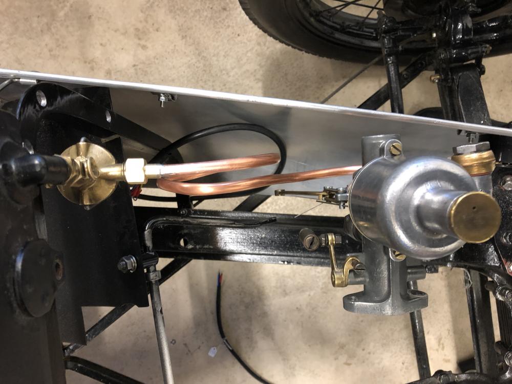

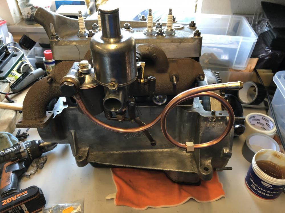

Just stripped and rebuilt the OM SU and will fit the AN needle as advised plus have sorted out
A neat petrol filter. Waiting on some pipe bits to
To finish off.
I’ve an original tank , but unsure whether to coat the inside,
Or rumble some ball bearings in it, or let sleeping dogs lie?
I changed the filler cap to a screw on one.
Any suggestions about the inside of the tank.
Plus sent the rad shell off to the platers, so better start
Saving up!
Regards
Bill G

Are you aluminium plating the cowl Bill?. That would look good.
One fabricated in Ali would be even sexier.
1
Location: The Scottish Border
05-02-2019, 01:20 PM
(This post was last modified: 05-02-2019, 01:23 PM by AllAlloyCup.)
Hi Hedd
By the cowl, do you mean the fabric cover that original GE Cups used?
I am planning to do machine turning on the bulkhead which is an
extra bit of bling I’ve been contemplating as well as replacing the fabric cowl
With an easily shaped alloy part to replace it?
I have a shrinker stretcher and quite a lot of alloy sheet left over so I can probably
manage most of it myself. Would need to see how easy it would be to remove
In case I needed to do work under it though.
Will make a cardboard one, like the dozens of patterns I’ve made since the start!!!
Regards
Bill G
Perhaps by cowl you meant the rad shell?
No it will be nickelled as it’s a steel chummy one.
At some stage I may paint the car... but not this year
Regards
Bill G

Bill,
Have you considered fitting a pump?

Hi Ruaridh
The level at the jet head is well below the bottom of the tank
And numerous posts have said that this SU set up can work reliably
As long as the tank has a fair level of fuel in it.
This OM has a throat slightly less than 1” so I’m happy to try out this
Arrangement with the AN needle.
I had a daft thought that the other way to ensure a full fuel feed
was to fit an Ulster type air pump? If need be an SU pump can be retrofitted.
Has anyone tried this out on a Chummy with a non cooking engine.
Eg standard valves and camshaft , but alloy HC head, lightweight pistons
and steel crank, I’m not planning to do racing!
If I can keep up with Jim H or Malcolm P I’ll be happy enough!
Regards
Bill G
