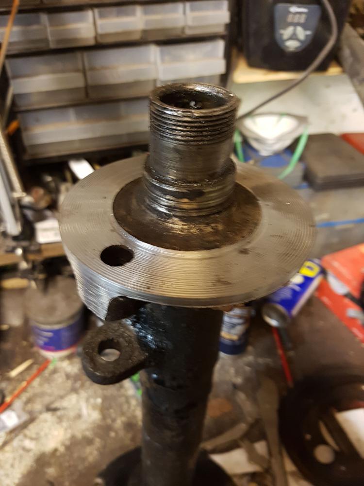

Having done this I've discovered an oddity and I'm after advice.
I turned down the brake backplate mount so that it just cleaned up the boss for the spring mounting pin. This gives an OD of 4.25 whereas a Girling backplate needs 4.00. See the picture. I wouldn't want less metal around the pin.
Did Austin alter the spring or pin position for Girling brakes or am I unlucky in trying to adapt the "oval backplate" 1935-ish brakes? Or perhaps this is normal and I'm worrying unnecessarily!

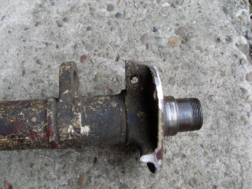

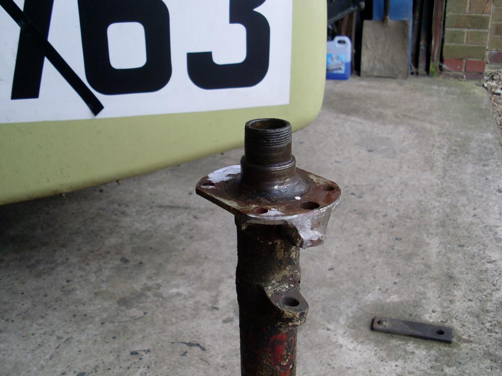

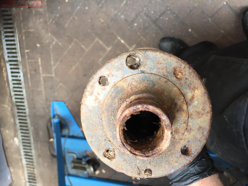

I hope these help you Charles.
(03-06-2018, 01:34 PM)Ruairidh Dunford Wrote: I hope these help you Charles.
Perfect. Thanks R
I'm being more cautious in how much metal I was leaving around the pin. I suppose because it goes in at an angle there is more metal around the inner part of the pin
Charles

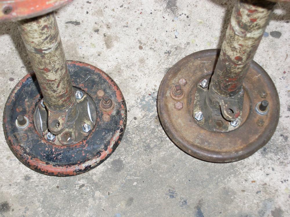

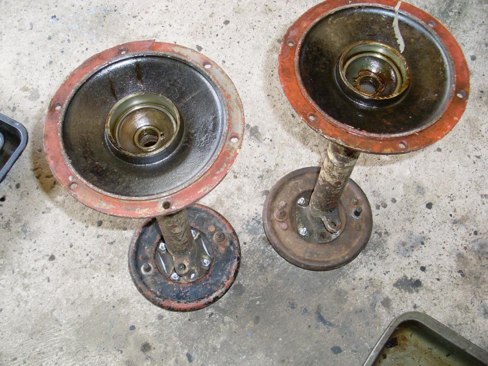

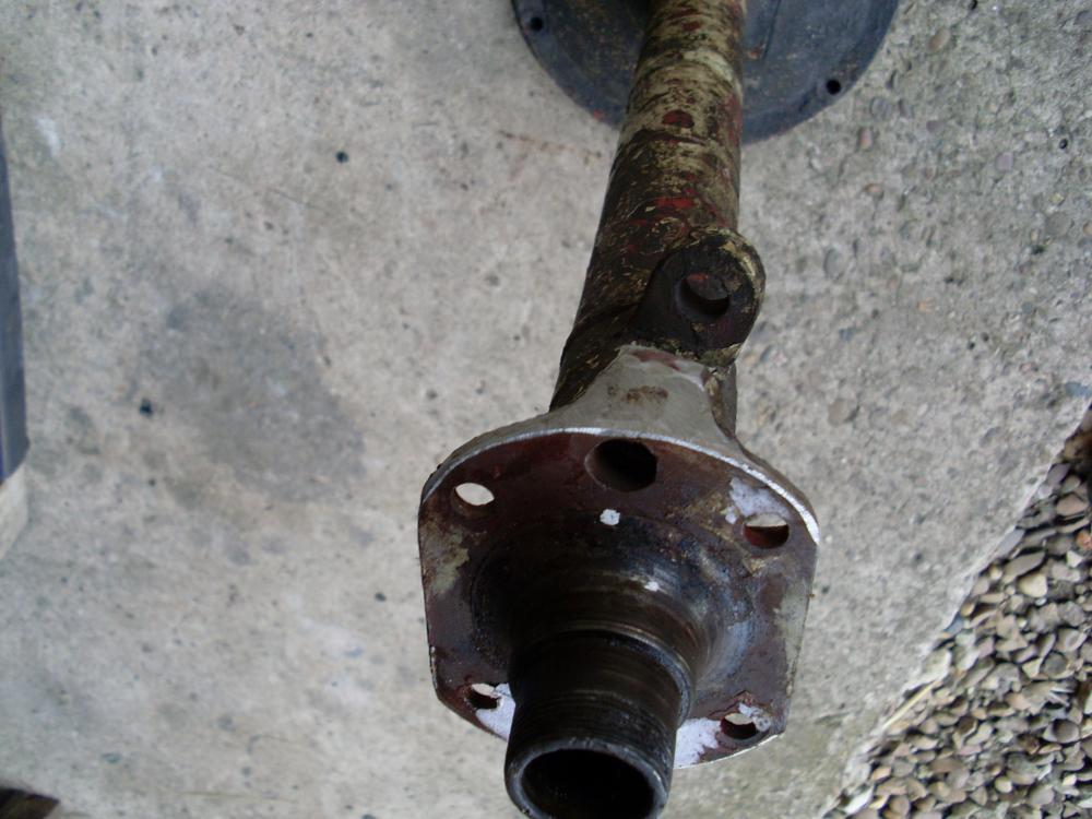

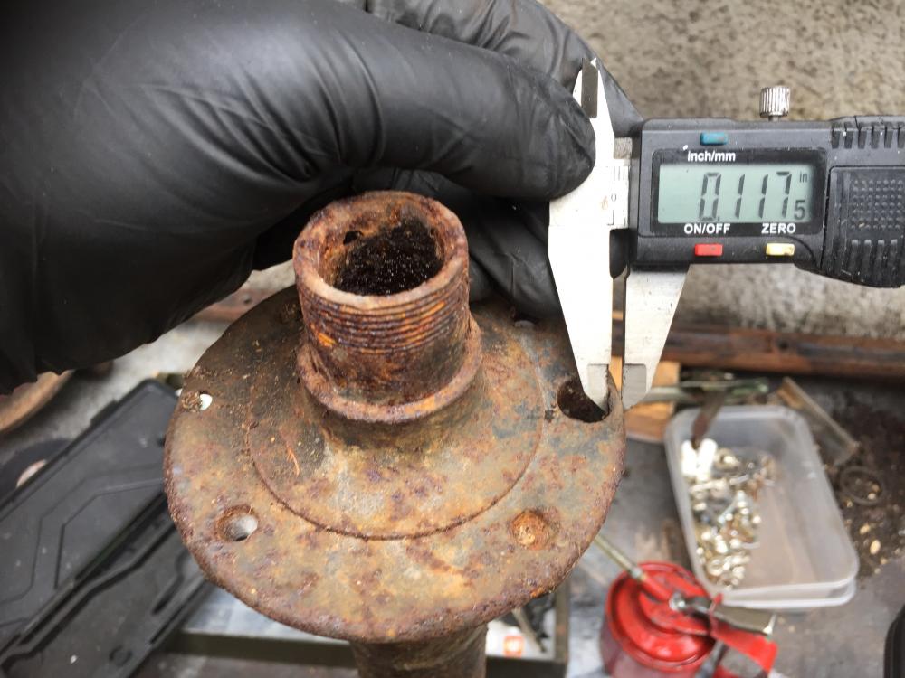

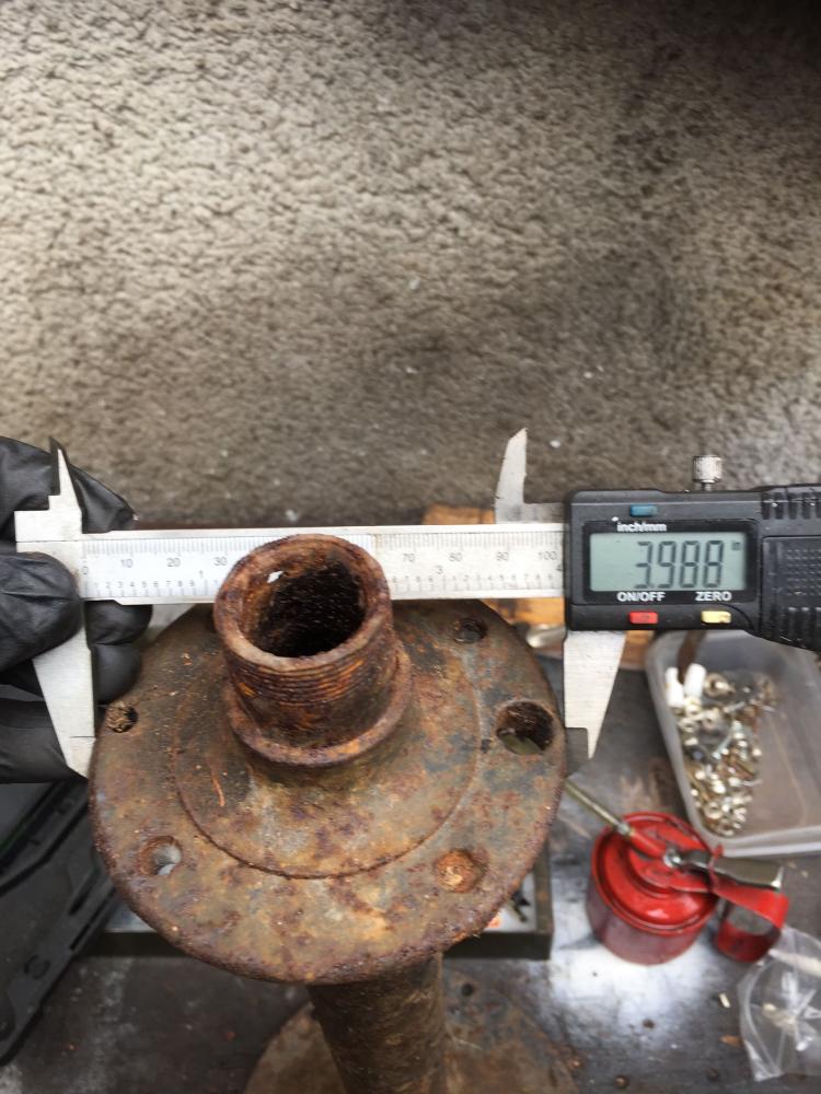

I did exactly this three weeks ago, Charles. I didn't think it would work either, but it does. The key is when you realise how little metal there is between the pin hole and the outer edge of the hub flange on a Girling axle as demonstrated by Ruairidh's photos. I'll take a backplate off and photograph what the finished axle end looks like later today.  In my case, the axle had already been modified to take Morris hydraulic backplates so 75% of the work had already been done when that modification was made, probably about 1960.
More photos, Charles. Note the 'angle grinder' finish!! Whilst the diameter of the hub flange needs to be a nats under 4", it only needs to be that at it's most outer edge. From there, the outer pin bracket can be formed at an angle leaving a fair amount of metal in place.

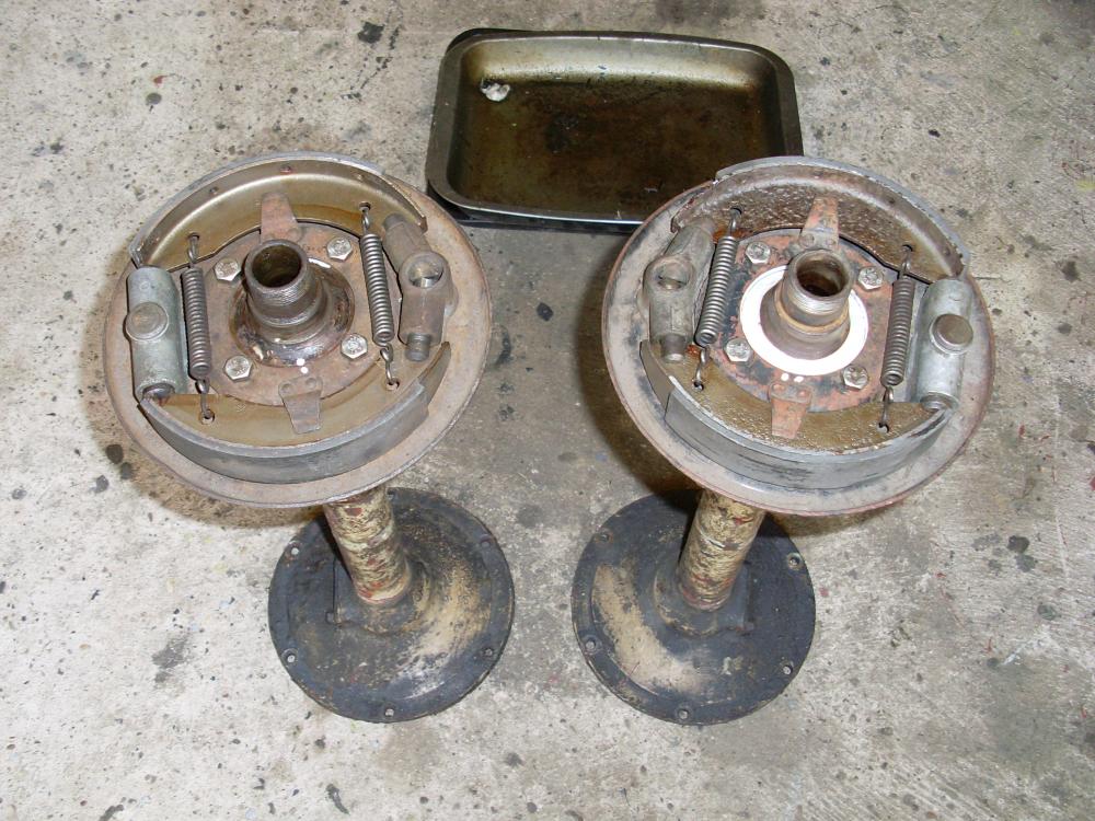

I don't know if this picture helps.  Unfortunately, I don't have the axle any longer.
Thanks chaps.
I might achieve the taper by means other than angle grinder (posh eh?) but it'll serve the same purpose.
Charles
Mines been like that for the best part of 40 years, Charles. Been ok so far.
