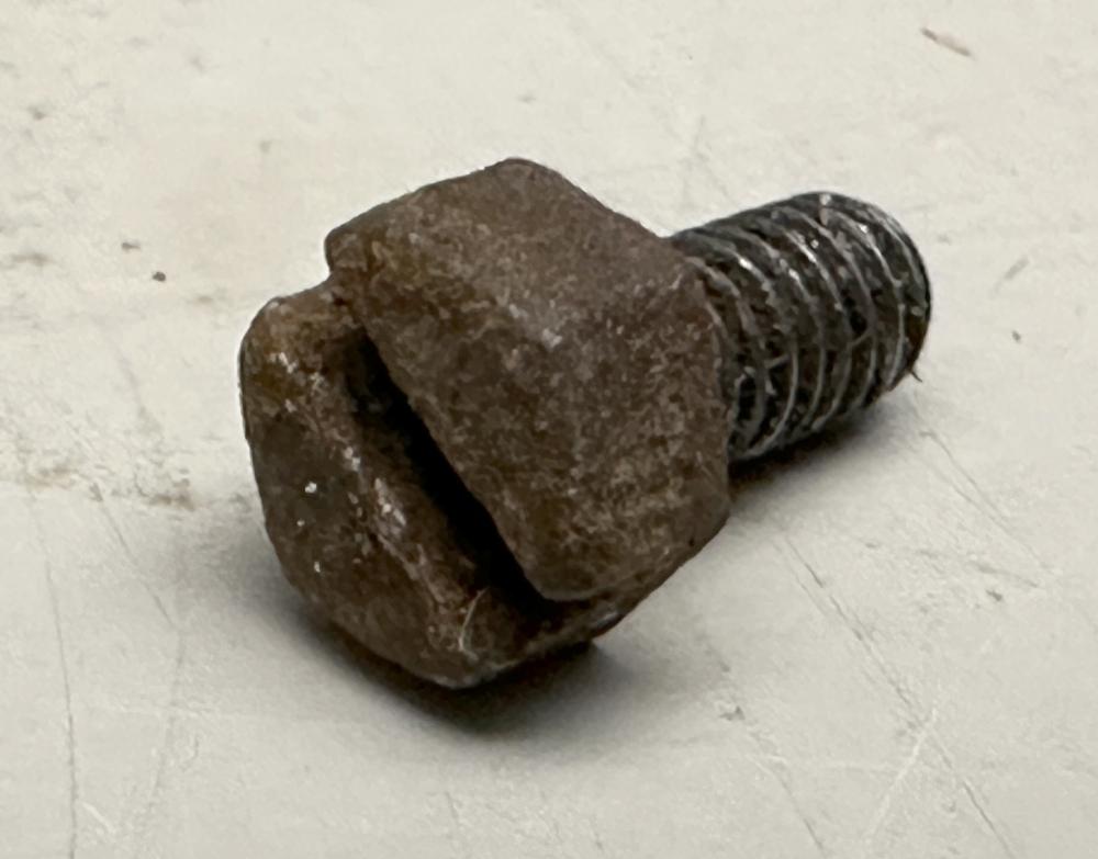

That looks great, Ruairidh.  Do you happen to know the small screws thread size please?
I don't, sorry.
(05-03-2025, 05:41 PM)Ray White Wrote: That looks great, Ruairidh.  Do you happen to know the small screws thread size please?
The two screws that hold the condenser on are in steel with a 5BA thread and of a very rare type - they have a hex head and screwdriver slot.
You can buy them online here:
https://www.chronos.ltd.uk/product-categ...e-ba-bolts
and here: https://www.ebay.co.uk/str/maccmodelengi...&_tab=shop
amd here: https://www.ba-bolts.co.uk/steelba.html
You'll have to cut the screwdriver slot.....
This is an original:
