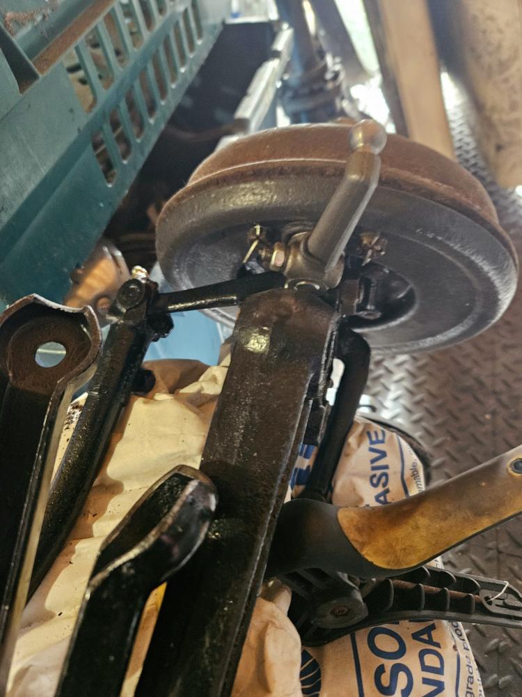

I am almost certain that the cams you have fitted are incorrect.
I can confirm this in a few days time, others may be able to do that sooner. The ball on your lever has been cut into but the cable cap and does not look safe, to me.
When the cam is at rest the lever should point down and forward, your current set up looks to point straight down at rest.

As mentioned earlier, I don’t think the slots for the cotter pins are machined in the correct place, on the cams you currently have.  They appear to have been made incorrectly.
I can post photos later in the week if no one else can illustrate the issue before then.

Hi, here is a picture of the Brake cam on my rebuild axle.
