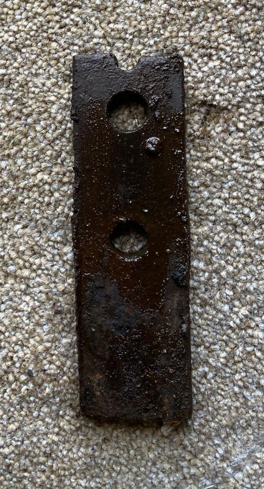

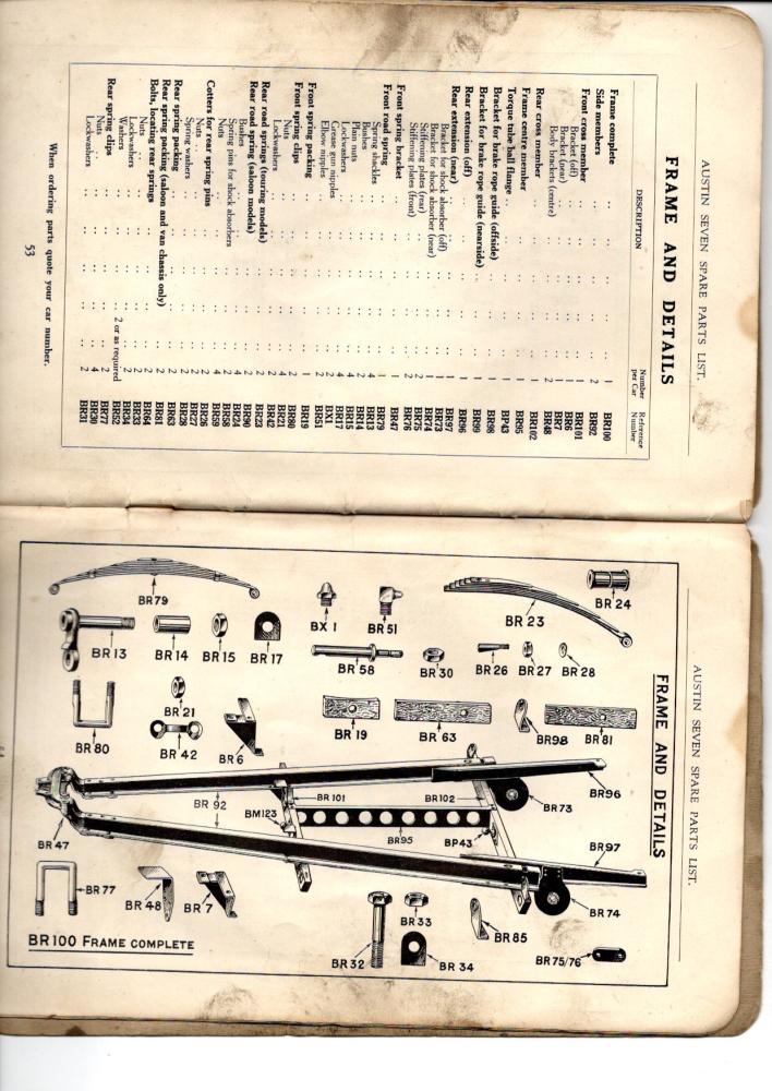

I was surprised to find a "packing piece" about 6 inches long below the spring inside the chassis frame. Research shows that this packing piece shoud be A7 Spare Part  BR81 .. The car being a long-wheelbase Box Saloon
My question is does anyone have the correct dimensions for the BR81 (length, Width, thickness). The width should be the same as the spring. The position of the hole in the packing piece, which I assume aligns with the main front bolt of the spring, would be useful.

I don't see how I could manage without a packing piece as it would leave a 5/16" (approx) gap. The piece in my OP pic is definitely steel.
I notice David Cochrane has BR63 and BR81 listed in his index, but both out of stock.
