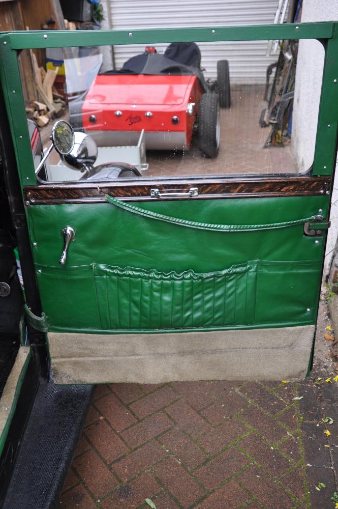

My door cards are made out of plywood and the only bulge is the one created by the metal cover plate over the winding handle. Standard Saloon:
[Image: WP_20170927_13_41_58_Pro.jpg]
RE: RP Door Card - Bill Dixon - 28-02-2018
My Stanard Saloon has the metal cover plate on the outside of the cover panel. When I obtained in 1970 it still had the original cover panels so it should be correct.
RE: RP Door Card - stuartu - 28-02-2018
(28-02-2018, 05:42 PM)Bill Dixon Wrote: My Stanard Saloon has the metal cover plate on the outside of the cover panel. When I obtained in 1970 it still had the original cover panels so it should be correct.
I wondered why I couldn't understand the problem. My Dad's 1931 (he bought it in 1957) saloon had the untouched moquette upholstery with the cover plates rivetted on the cabin side of the panel as Bill describes. When we eventually reupholstered it I remember re rivetting the cover plates back onto the plywood door "card". No clue if the RP would be the same but it would seem likely that it was. Seems like a better idea to me. Am I misunderstanding the arrangement in the RP?
Regards,
Stuart
RE: RP Door Card - Hugh Barnes - 28-02-2018
No, 'fraid not, RP should have the cover plate behind the leather covering... I think there is plenty of photgraphic evidence to support that if you have a look around...
