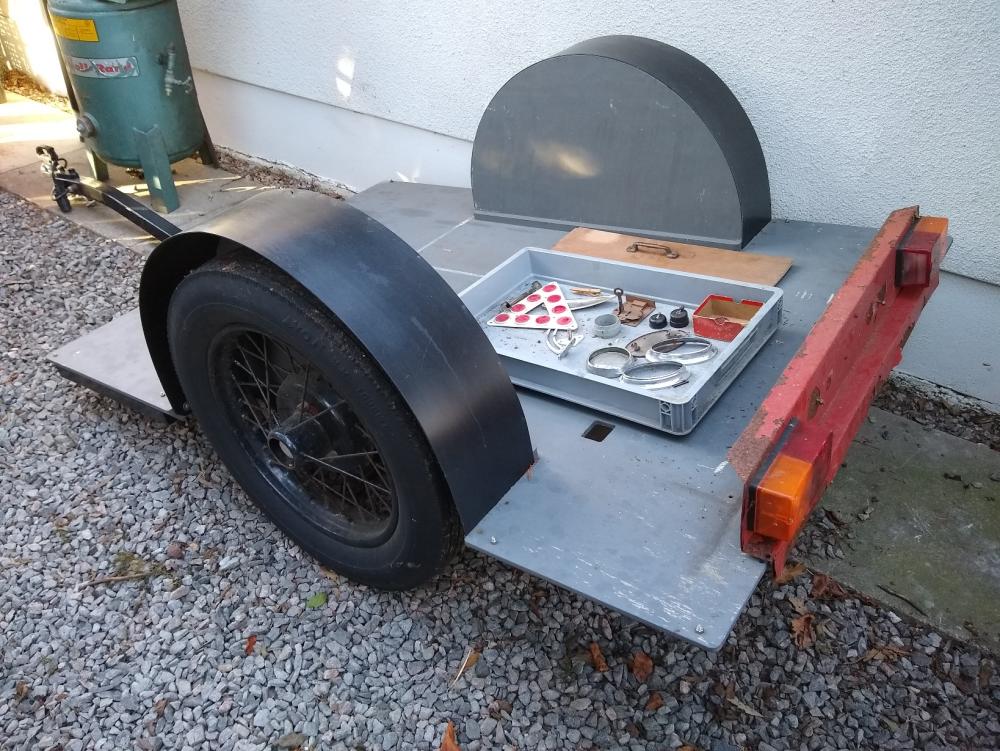

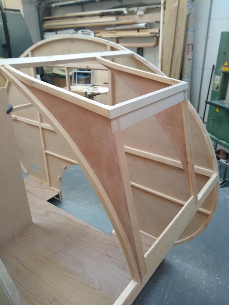

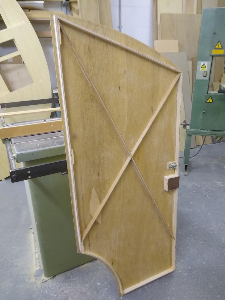

Scottish enthusiasts may well be familiar with the old camping trailer we tow behind our Ruby. In actual fact it's a caravan chassis with Austin seven hubs and wheels. I took advantage of a lull in customer orders over Christmas to begin work on a new body for it, the design of which I've been pondering for years.
The principles are minimal weight, minimal size, original 'scrapyard' fittings, and art deco styling.
Don't expect it to be finished by the summer; my daughter pointed out that I have been talking about it for 10 years and only just started work!

It looked superb yesterday, but these photos suggest even more progress!
Cannot wait.
RE: Austin Seven caravan - Peter Naulls - 15-02-2023
No more progress since your visit - it is in kit form at the moment as I really have nowhere to keep it once assembled!
RE: Austin Seven caravan - Duncan Grimmond - 15-02-2023
That looks very interesting. Just for my curiosity, what are the overall dimensions? (or floor length and internal height)
I'm aiming at 150kg if only because that's the weight of a couple of passengers so it seems well within the car's capabilities. The rolling chassis is about 50kg so I don't have much to spare. I am having to be obsessive about the weight of each component but not at the expense of the fittings, some of which are Austin 7, all of which are of that period.
I'm hoping to coachpaint it but don't have any experience. Craftmaster will be a useful supplier I assume.
I like the finish on the Pytchley Malcolm, unusual and appropriate. Thank you for the offer of fittings, I shall let you know when I get to the fitting out stage (it'll be a while) but at the moment I think I have everything except window catches. I have a couple of old, small draw bolts but would really like 4 the same.
The overall size is 7' 6" long by 4' wide and about 5' headroom. The design allows for a 6' x 4' bed or a seat and table. There will be a 9" wide worktop /kitchen in the curve at the front end.
