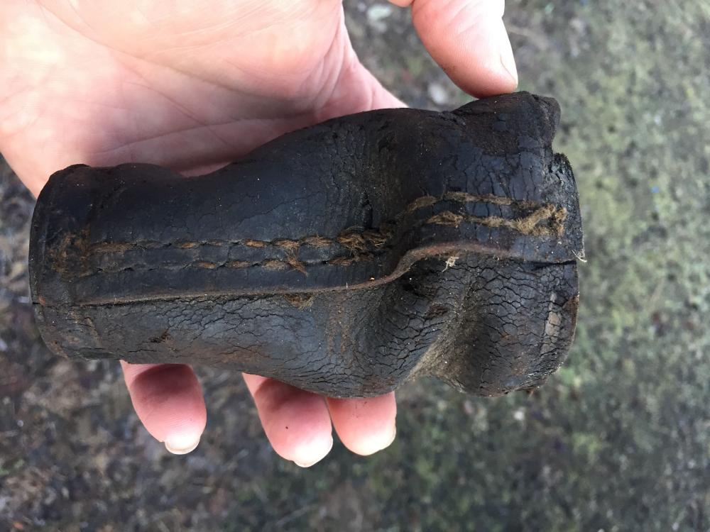

RE: propshaft leather gaiter and bobbins - Ruairidh Dunford - 26-01-2018

RE: propshaft leather gaiter and bobbins - Ian Williams - 26-01-2018
The bobbin appears to be the same as the one I have, can you tell us what length the leather gator is please Ruairidh
I will have to go back and measure Ian - will come back to you in the next few days.
