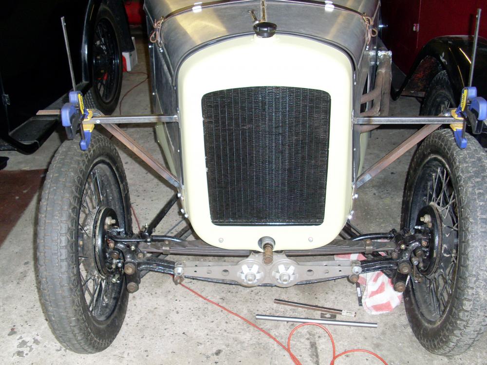

RE: Wing supports for Ulster Rep. - Steve Jones - 19-01-2018
You're right, Erich, because Austin never supplied an Ulster with cycle wings, wing supports were something that relied on the ingenuity of the individual owner and that continues to be the case today. They're all, mostly, different.
This is how my rather minimalistic versions are:

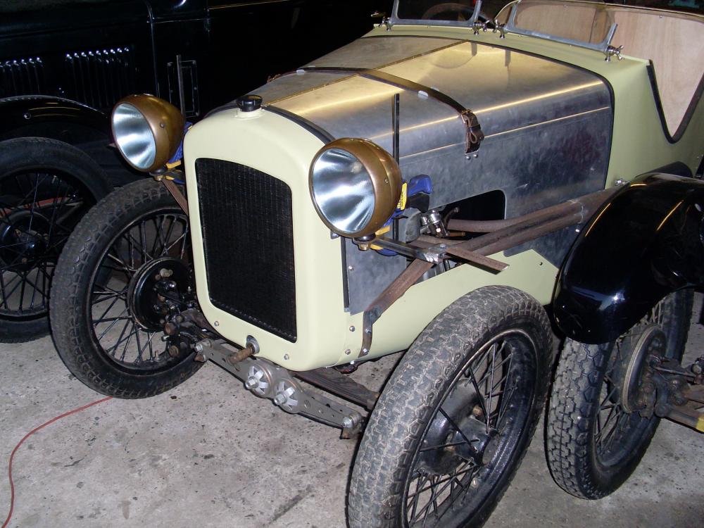

RE: Wing supports for Ulster Rep. - cardiffrob - 19-01-2018
A slightly different method.

RE: Wing supports for Ulster Rep. - cardiffrob - 20-01-2018
I'm building some more curvy front wings so will have to remake the bracketry. I want the lights slightly further forwards so that the opening bonnet doesn't chip the headlamp paint. Design flaw!
I still need to 'drop' the front axle some day.

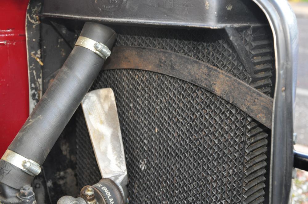

RE: Wing supports for Ulster Rep. - JonE - 20-01-2018
slightly off thread, but for the upper mounts, remember that if you want to use the cowl-side connection as per Steve's photos, Rod Yates has repro cowl stiffeners/support bars in stock that go in behind the rad and connect up to the cowl positions... running in an arc over the top of the fan blade. Also used on 65 and Nippy. Neat...
RE: Wing supports for Ulster Rep. - Steve Jones - 20-01-2018
(20-01-2018, 12:48 PM)JonE Wrote: slightly off thread, but for the upper mounts, remember that if you want to use the cowl-side connection as per Steve's photos, Rod Yates has repro cowl stiffeners/support bars in stock that go in behind the rad and connect up to the cowl positions... running in an arc over the top of the fan blade. Also used on 65 and Nippy.  Neat...
Absolutely correct Jon and if you're using wings with any weight to them then I'd suggest this, or something similar, is a must so as to avoid any eventual distortion to the sides of the rad shell. However, my set up is about as light as it can get and I don't have a supporting cross bar. Four and a half years later, many road miles, 39 hillclimb and sprint events and one barrel roll at Loton Park, the rad shell remains undistorted so, probably, not essential for a lightweight set up.
