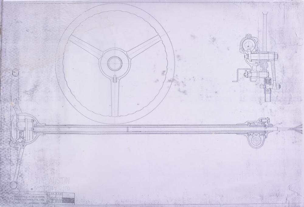

Archive drawing XL335 May 1937 shows a bearing either side of worm.

The drawing Dennis refers to. This is a copy of the new images that I am in the process of uploading to replace the earlier, lower quality images made some years back. This is a slightly lower resolution version that will not be the final version that gets uploaded.
Hugh

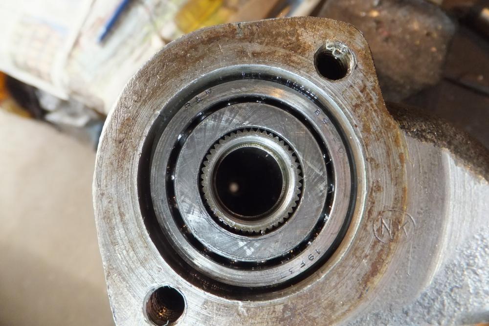

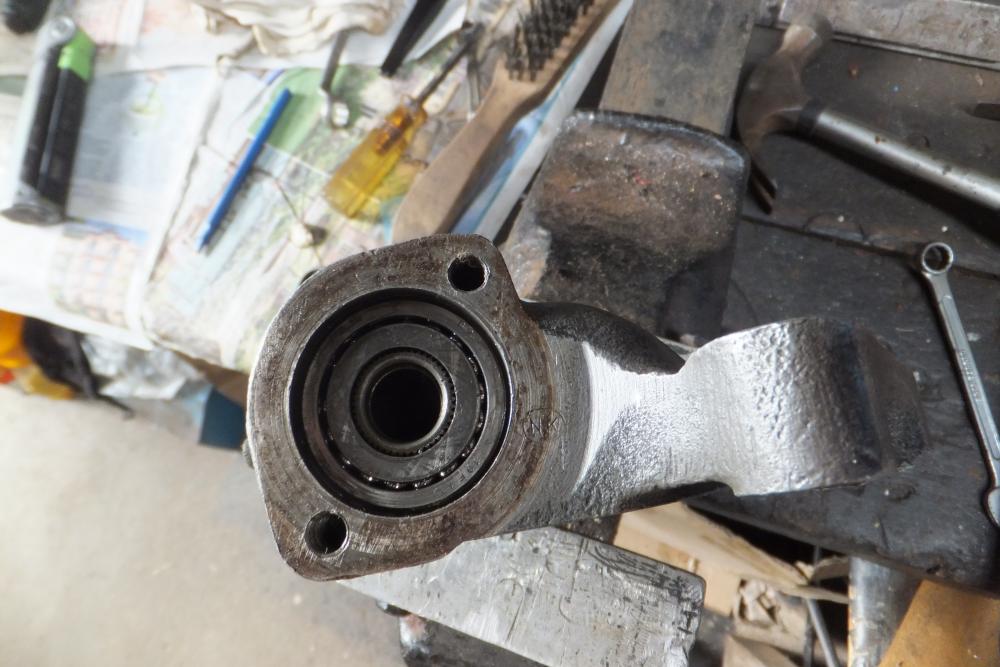

trying photos again.  Computer must have had a good nights sleep....it is adding photos  BUT it has doubled up the close up of the column end......not my doing honest.  After the heading "side view end plate" the next 2 repeat photos of column end close up have appeared by them selves! Only 4 posted by me...first 2 and last 2.......intriguing?  The last 2 are not showing up in the Message box attachment list either but are clearly there.
end view of box showing bearing.
Side view end plate 1A6117

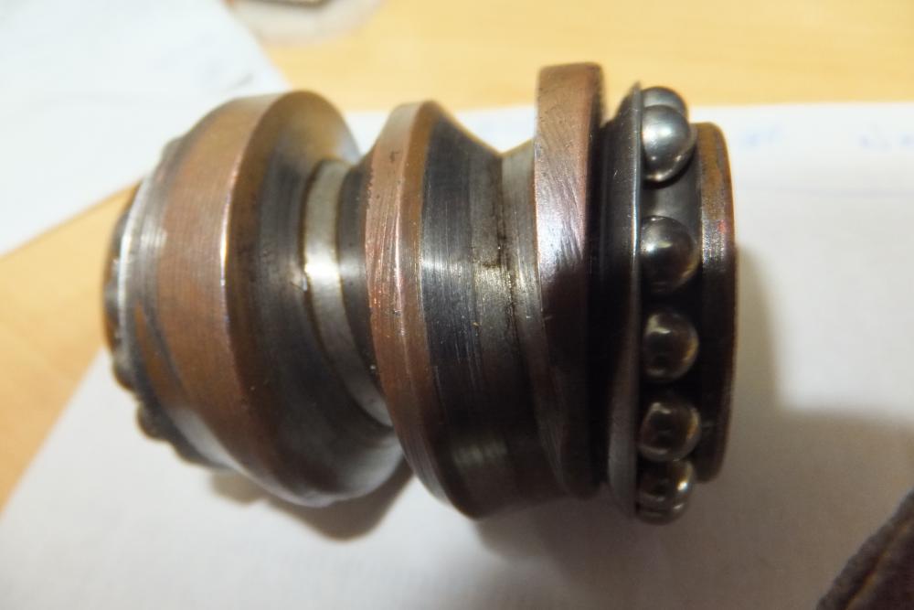

The worm and bearings are stripped off the splines of the inner column.
I think penny has dropped and believe the hitherto mysterious oil seal 1F6106 and its retainer 2K5046 (just a washer?) can be seen in the last photo with 2K5046 held in place by the 4 punched indents and under it the felt seal.

The balls run in the worm itself with the 1A6131 "bearing cup" forming the outer race and the 1A6124 "bearing cage there just to keep the 17 balls in place.  The balls can be put in place pushing against the slight springiness of the cage.
The 2 bearing outer races of this box are too badly marked to be useable.  They are an interference fit in the box.

Just playing some more have noticed the 2 ball outer races have same B9720 engraved as has the end one on the box I am hoping to use (first lot of photos) but further engravings are different;- 19D3T,  19A3T and in photo 19F3T.....all are R&M.
Anyone explain what these indicate?
They are obviously angular contact so good for radial and axis loading.
