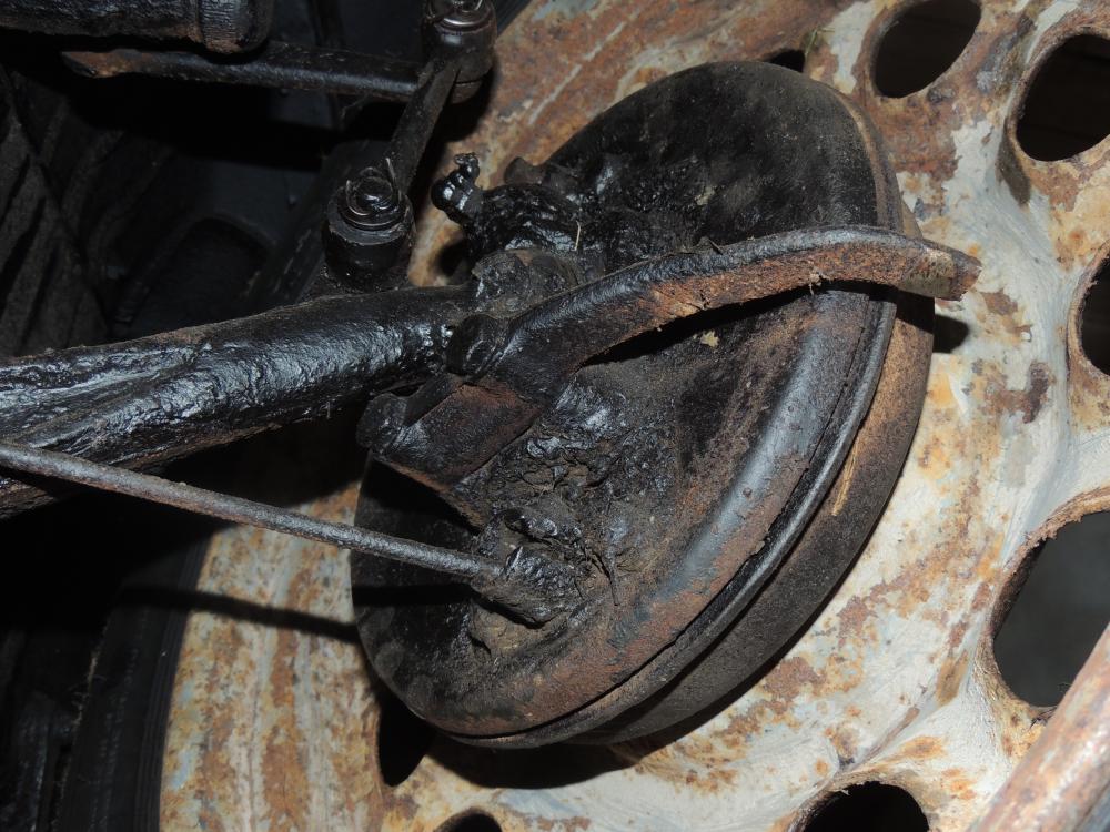

Hi guys sunday past" drive it day " ended in disaster coming to a grinding skidding abrupt halt. Investigations revealed the track rod had parted company by the n/s steering arm having snapped off on my 1939 Austin 8 AP tourer with the roadwheel at a very strange angle . (my 1929 A7 van is in bits ) Now fortunately for me a very kind near neighbour assisted me to get my car back to my house by kicking the n/s roadwheel to the required direction as I very slowly drove it back home having bungeeg the track cross rod up to stop it dragging on the road  (had only gone 100 yds when the steering broke) As I am 76 and getting to bloody old for this kind of thing . Would any of you kind souls know if the A Big seven or indeed the seven steering arms be of use on the 39 AP tourer .I would want to renew both and also the track rod ends .Also would anyone know if the A30/35 ones would be of any use (I have fitted the a series engine ) and it runs sweet using a modified back plate and the original gearbox ,All and any advice ,suggestions are most welcome (we invest in our Austins) thanks regards Ally Sad Huh

It's not for an Austin Seven it's for an Austin 8. No idea if it's the same part. A photo might help.

        Hi Reckless dimensions are 9" long with 1,1/2" fixing bolts pitch .Cheers Ally
RE: steering arm broken - Reckless Rat - 28-04-2021
There's nothing on an Austin Seven (Big or otherwise) like that. You're going to need to source it outwith our cherished suppliers if I'm not mistaken. Looking at the ball joint end, it looks like it has been cracked for a while. I would check the other side while you're at it.
