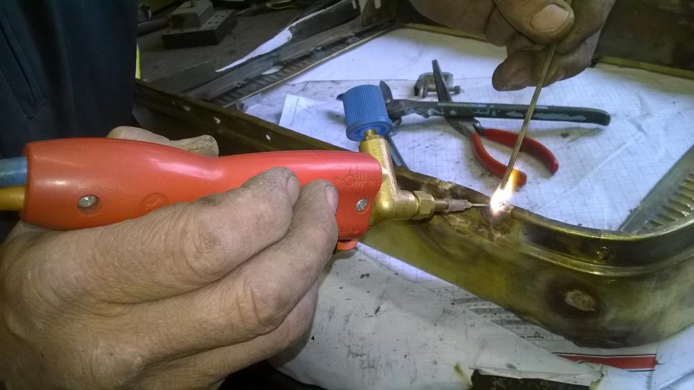

            I have used the Turbo set 90 ( found on EBay £111) successfully for several years , a workshop must as far as I am concerned. As previously stated , fluxed rods are preferable for most jobs , thinner none fluxed with a tin of flux powder can be of use for minute jobs. My turbo set came with what is effectively hypodermic syringes as welding tips, one shown on attached photo. There are also a range of larger brass tips for larger jobs.
As I say I have used this kit for all manner of uses and couldn’t do without it.

Derek, looking at that kit, what is the difference with bringing oxygen into the mix? (as opposed to MAPP gas which is just one cannister) I can see that gets a lot hotter... presumably so you can put less "in", at a higher energy density?
RE: Silver soldering advice - Derek Sheldon - 07-06-2020
    ad you can see from the photo this system has a very high heat range. The oxygen is the big contributing factor. The main benefit is that you can get intense heat from a flame not much larger than a needle, this helps greatly with metal distortion . The heat is there directly and doesn’t have time to spread into the workpiece .

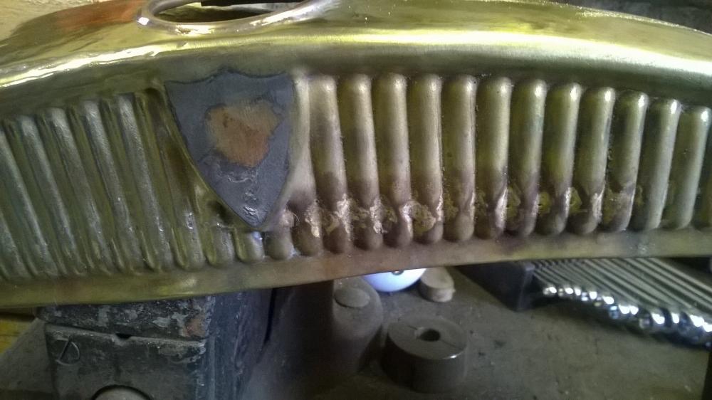

    same area post repair and plating
