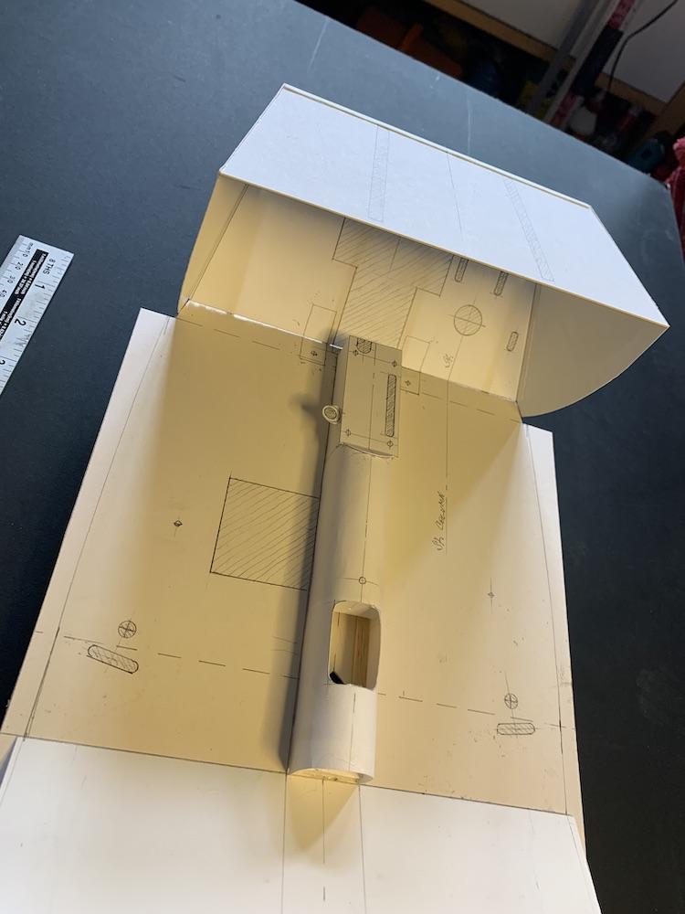

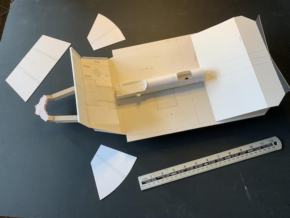

Years ago I bought the remains of a very battered TT body.
Just recently we decided to move it up the project list so it has been rescued from the rafters and it was set up on a slave chassis to get measurements.
Apart from the crash damage it needs a new front floor and bulkhead.
At the end of March I started by working 1/4 full size on the drawing board and then a simple 3D model to determine/confirm panel shapes and sizes.
I hadn't intended to go further as my thoughts and queries had been resolved but my son suggested that I should carry on, so having nothing better to do......

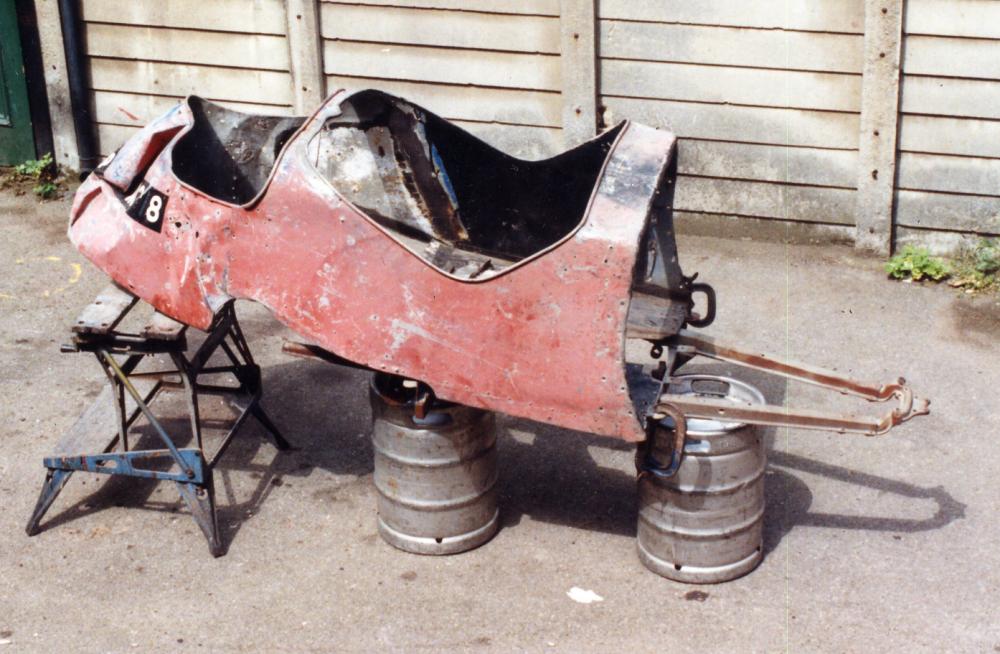

So far i have no history of this body before 1959 when John Harris (no relation) bought it with a job lot of sports spares from a dealer somewhere in North London.
The first colour is orange, the next blue and then the powdery faded red.
I think Holland Birkett's car was green?
TT bodies seem to have no numbers.

The TT bodies are very fragile. The floor and tunnel are aluminium.
This is one of three remaining, they have all suffered serious damage from metal fatigue, accidents and butchery, this one perhaps more than the others. The front floor, tunnel and body sides have been replaced in all three.
The registration isn't 828. This is it at Beaulieu in 1981?
