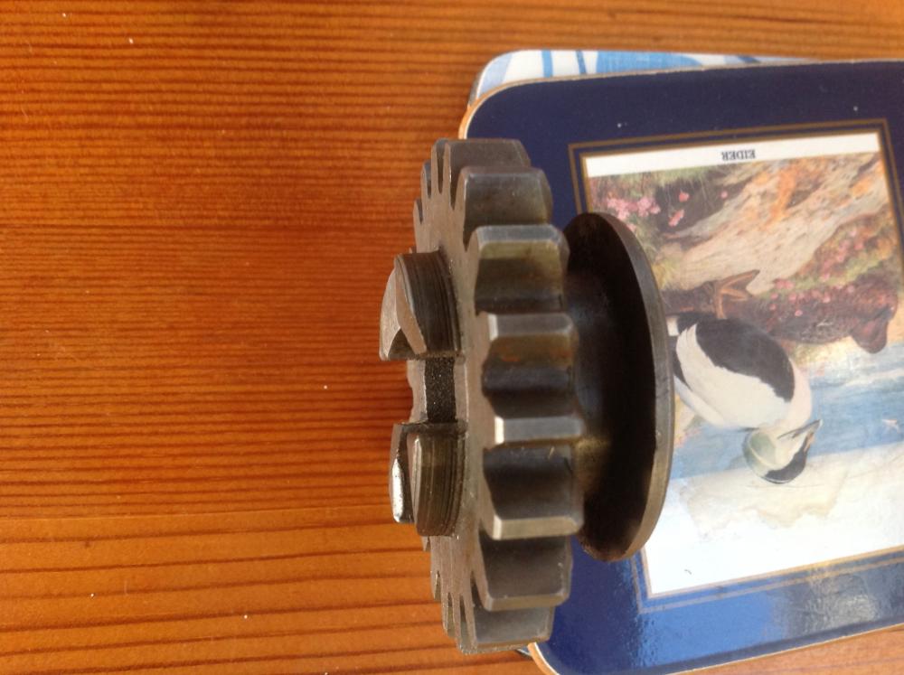

RE: 3 speed dog ramp - Zetomagneto - 26-02-2020
Hi Ian, here is a picture of an Andes gear, I have not fitted them yet so can't comment on how well they work. Best Wishes Gene

RE: 3 speed dog ramp - Joss - 26-02-2020
Thanks that picture confirms my thinking we shall proceed down that route

RE: 3 speed dog ramp - AustinWood - 27-02-2020
Just ramping the one side seems to work fine.
RE: 3 speed dog ramp - Ian Williams - 27-02-2020
Jim, I feel ramping both sides would be a mistake, the ramp would need to be on the side of the dog not normally loaded, if you ramp both sides of the same gear you defeat the object of catching the corresponding gear. If you ramp the ist motion shaft and the 2nd gear, or cut the ramp too deeply you run the risk of it jumping out of gear on the over run.
