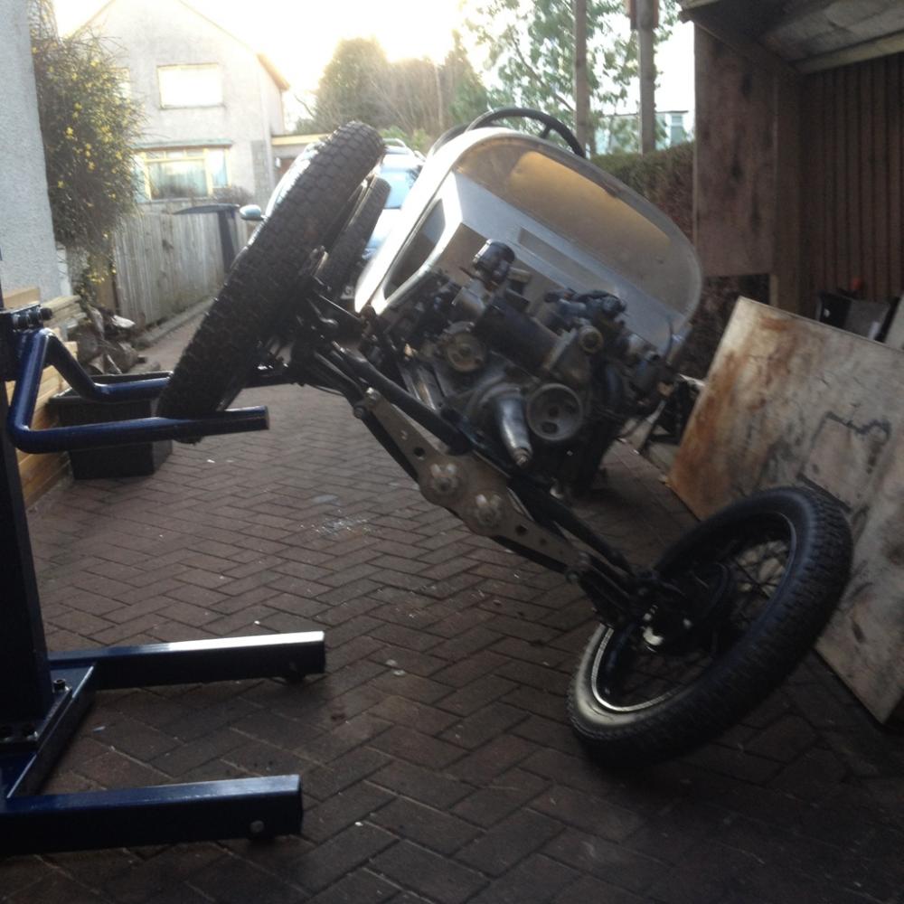

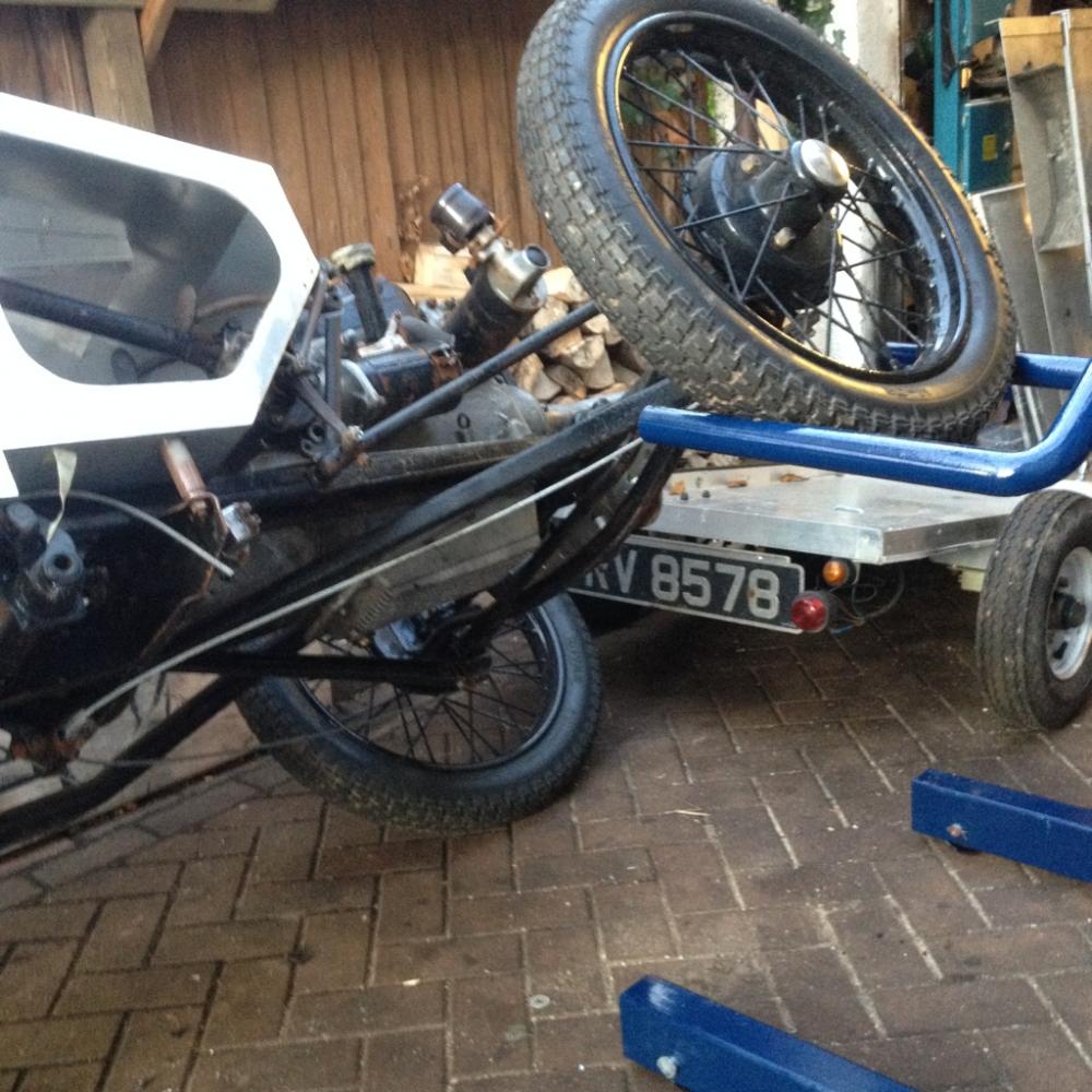

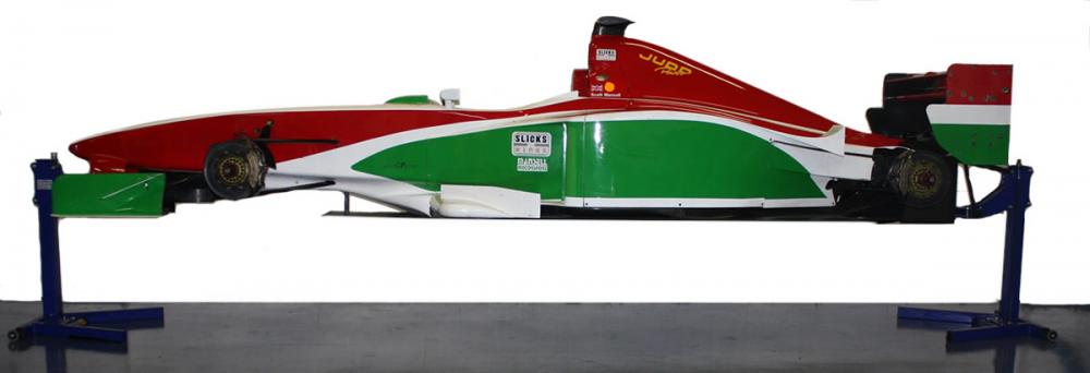

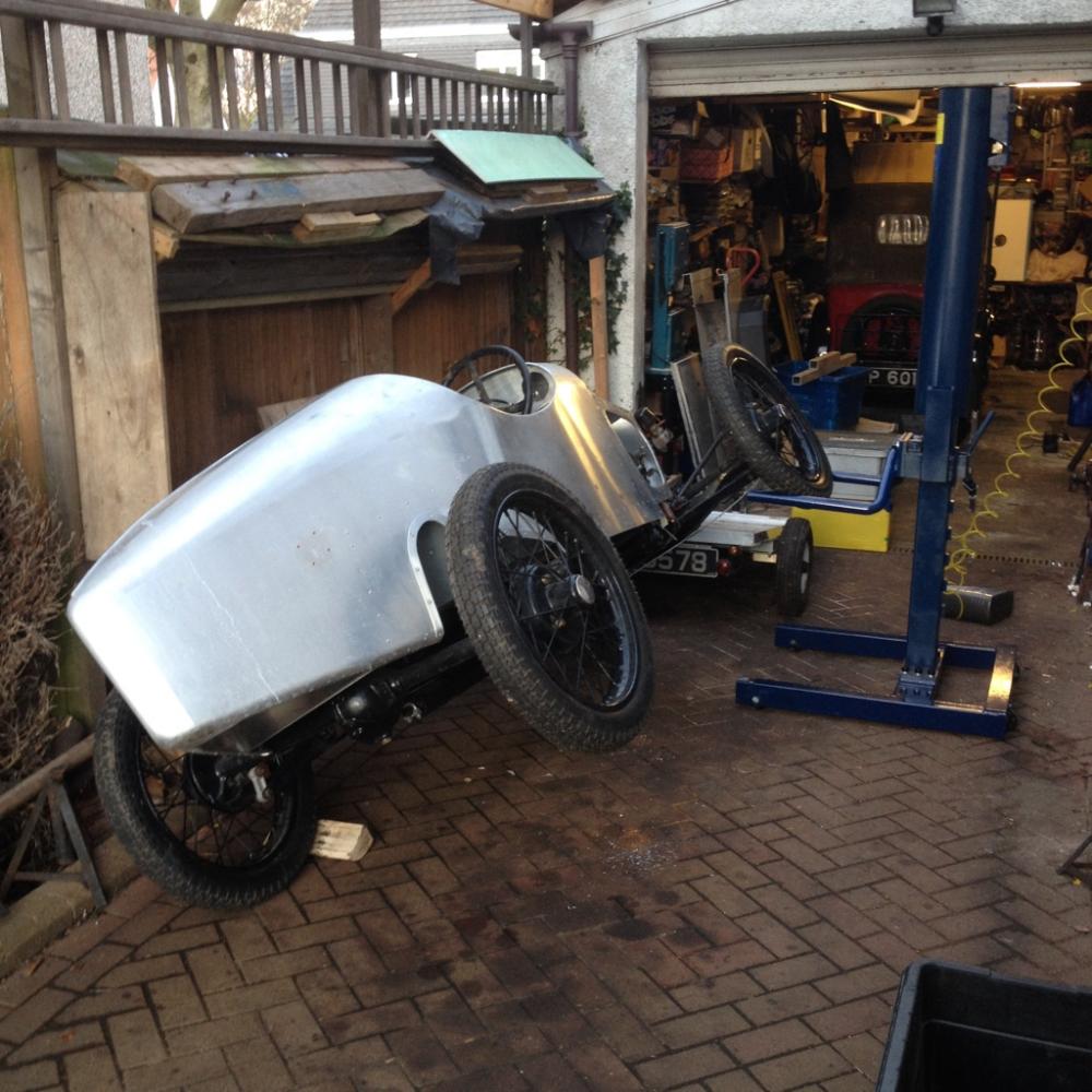

RE: Vintage cars on 2 post lifts - Marcus Ling - 02-03-2021 They often seem to be sold as a pair but principally for single seaters, that's why I was curious if anyone had ever used them to lift a road car up. RE: Vintage cars on 2 post lifts - Colin Reed - 03-03-2021 HI Steven, As you have the large Garage with a high roof my preference is a Four poster some reasons for car stable on all four wheels clear area under when hoist is lifted room under for gearbox hoist draining oils and water adjusting brakes Room for one or two Jacking Beams Maybe i am Biased I have a Laycock Coronation 1955 model one of the first four poster hoist imported to nz purchased 6 years ago completely rebuilt New Parts still availably of the shelf in Northhampton and at a good price Make Life easy Colin NZ RE: Vintage cars on 2 post lifts - Ruairidh Dunford - 03-03-2021 My apologies Marcus, the ones in your pictures are obviously quite different from the one I have. RE: Vintage cars on 2 post lifts - Marcus Ling - 03-03-2021 No problem, the ones in the photo would probably not work too well if you tried to lift up only one side as they don't have any wheels, unlike a trolley jack, and once the car starts to come up there might be tendency for them to tip as they cant easily move on the floor. Do you have a photo of the one you have? Thanks Marcus RE: Vintage cars on 2 post lifts - Ruairidh Dunford - 03-03-2021 I do, let me find it and come back to you. RE: Vintage cars on 2 post lifts - Ruairidh Dunford - 03-03-2021 RE: Vintage cars on 2 post lifts - Marcus Ling - 03-03-2021 Thanks Ruairidh, Yes very similar concept but has wheels to move whilst lifting and designed to lift on a wheel. I've seen a similar lift which fits under the sill to lift only one side. RE: Vintage cars on 2 post lifts - Ruairidh Dunford - 03-03-2021 I have the sill attachment with this too. RE: Vintage cars on 2 post lifts - MartinH - 03-03-2021 Probably not an option for the original poster in NZ but I have a manual 4 post lift made by Hamer in the UK. It works very well with easy adjustment of the width between ramps. No power required, apart from manpower to work the jacks. http://hamercarlift.com/ RE: Vintage cars on 2 post lifts - Hedd_Jones - 03-03-2021 Ive got a no post lift ![]() Its brilliant, except when the wind gets up a bit |
