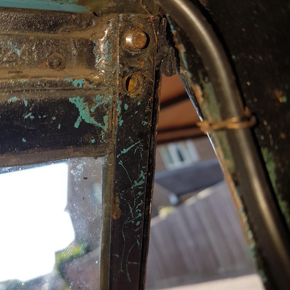

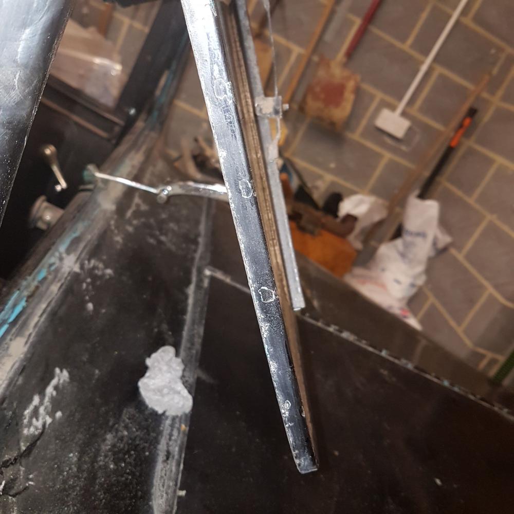

Thanks Dave. It doesn't look like I have an original then. These extra pics are 1. from the inside looking out. 2. Edge view. 3. Top hinge corner on drivers side.

I've finally managed to login after 5 days of trying. Looking closely at your photo 201745 there appears to be a cut down hardened rubber seal around the edge of the windscreen frame, how is this held in? The original seal was slid in from one end and it is quite a struggle getting it in. Below is a photo of the seal with the windscreen closed.
RE: RN Windscreen rubber - Biddlecombe - 24-07-2018
(24-07-2018, 08:59 AM)Dave Mann Wrote: I've finally managed to login after 5 days of trying. Looking closely at your photo 201745 there appears to be a cut down hardened rubber seal around the edge of the windscreen frame, how is this held in? The original seal was slid in from one end and it is quite a struggle getting it in. Below is a photo of the seal with the windscreen closed.
Thanks for that Dave, Gary Edwards thought the same when he came to have a look and suggested that I take the whole screen frame and all out and look closely. He thought perhaps that it was a U section with the rubber behind an insert?  I am a bit reluctant/not competent to go that route at moment, but if that is your view also then I will have a go. The frame seems a little rusty and I don't want to break anything.
I started by removing the two nuts on the inside at the top of the windscreen right hand side. The lower screw came out to the front no problem, the upper nut came off OK but the screw will not come out, it is obstructed by the top hinge. I started cutting out the rubber that was in the 2 mm gap between the inner and outer parts of the surround, but I cannot see how this inner is fixed to the outer and rubber except by the two nut and bolts at the top each side. I have tried gently to work an old chisel underneath the inner section at the top by the bolts but no luck. Any ideas?
RE: RN Windscreen rubber - Dave Mann - 25-07-2018
Ok that looks like a RM or early RN windscreen frame, I wouldn't try dismantling the frame in situ. You will find that there is a channel in the outside edge for the rubber seal, which is probably full of old hardened rubber, rust and years of crude build up. I would enjoy your car whilst we have this lovely weather which doesn't require a windscreen seal. Then in the winter months remove the whole windscreen from the car, the two bolts at each top corner hold the lower frame to the hinge, remove these and the lower frame and glass can be pulled off the hinge downwards. However it appears that rust, sealant etc may not let this happen. It may pay to stand the windscreen upside down in a length of gutter filled with Bilt Hamber's Deox C, environmentally friendly rust remover, for a few days before attempting to pull it apart.
