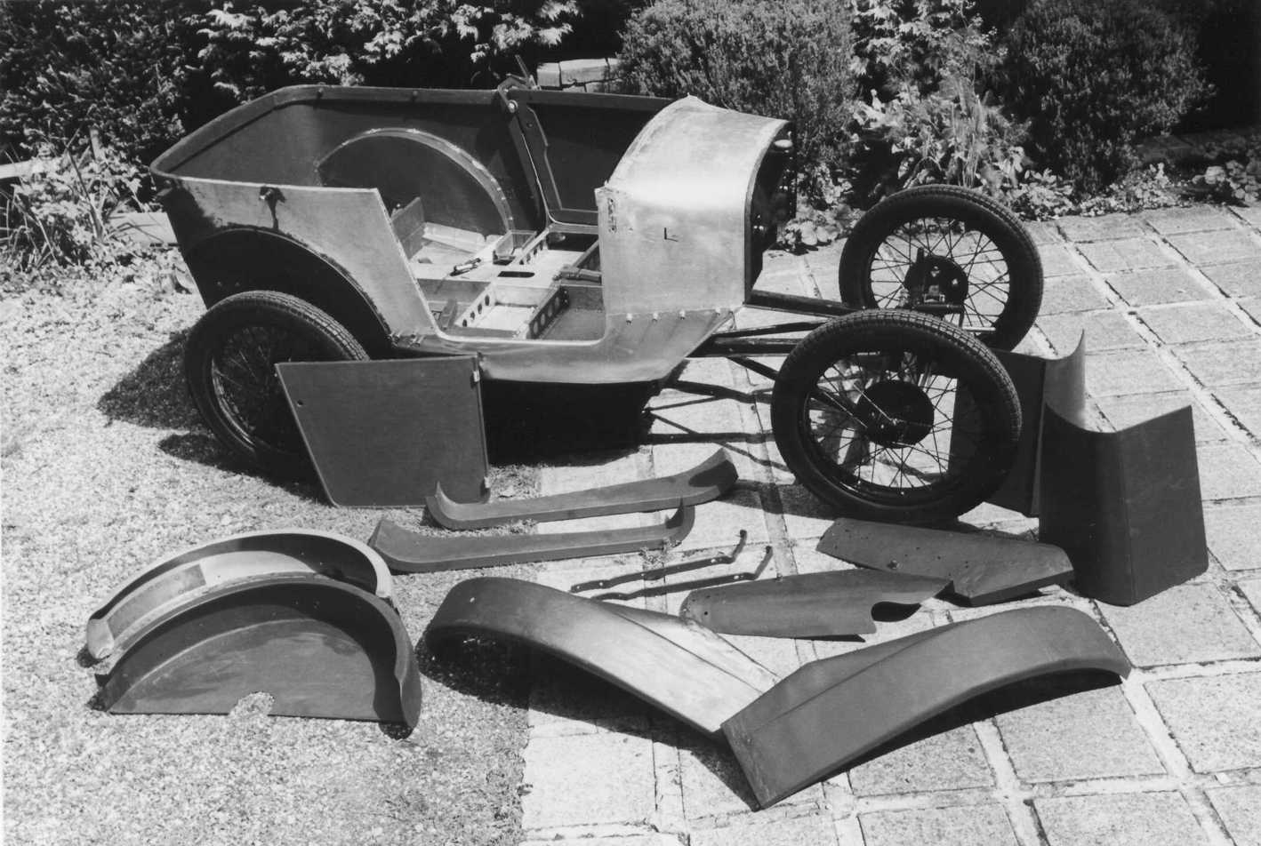

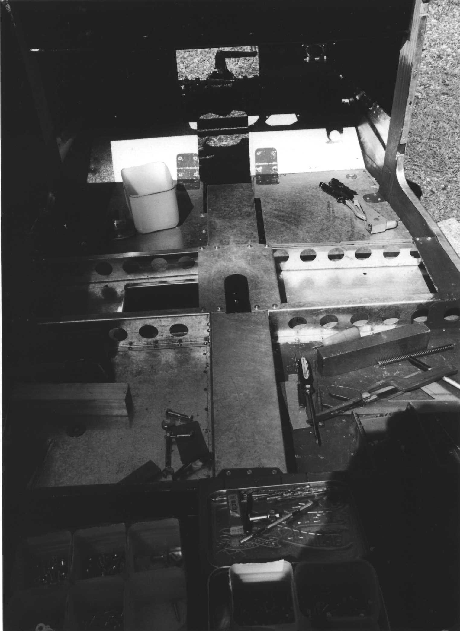

   Since our last report in the June issue, giant strides have been made with the fabrication of a complete new floor plan, from galvanised steel sheet, a tad thicker than the original, so it should last for at least another seventy years.
    It wasn't until we started to dismantle the body we discovered that we had bought, in reality, nothing more that a set of plans in rusty metal lacework. Undeterred, we dismembered the body piece by piece, taking many colour photographs to aid our memory of which item went where, and carefully measured each piece (although we have to admit that because of missing edges in some instances, the measurements became educated estimation), then cutting and bending metal to shape. After our first attempt at gas welding our carefully cut pieces together it was obvious the amount of distortion that had taken place could never be remedied by any amount of applied hammer blows. So we started cutting new metal from scratch and this time decided to bolt and rivet as the original body had been. The distorted version now leans against the Barn as a welded‑art garden sculpture.
    The accurate cutting to shape and size, allied to much use of a 90 degree square, resulted in parts which fitted together easily and meant that we could take it apart and reassemble for fitting of other parts when necessary. At this stage worries of whether our new floor would accept the few original parts that were useable (after considerable refurbishment) began to dissipate and we discovered that, yes, it did all fit together to make a rigid floorpan.
   This structure was then bolted temporarily to the chassis so that the bodybuilding could commence. About 50 per cent of the woodwork had to be replaced with some nicely grained, easily worked, ash obtained on order from our local woodyard and the bottom of the aluminium body on both sides had to be remade and rivetted onto backing plates with countersunk rivets. During all this work the use of at least eight G‑cramps and twenty or so aircraft skin pins were found invaluable.
    When the petrol tank and dashboard were bolted into position, the whole construction gained a rigidity we would not have thought possible when we cast our minds back to the structure as bought, which had all  the structural attributes of a bowl of spaghetti.
