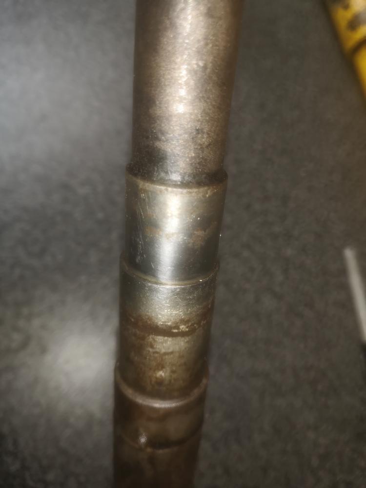

No Pete, this did begin life as an inner and outer piece, but no you cannot separate them.

Peter, thank you. I was searching 'brake shaft' but not getting much come up. Cross shaft is of course the correct term - total brain fade! Thank you!
Andrew cheers, that's interesting, I was under the impression that it was supposed to turn as a compensating system. I guess I need to do some more research!

Yes the outer it is supposed to allow movement to compensate for twist in the main shaft, however in practice this twist is almost nil and they often appear seized. They are pinned and plug welded at the centre so extremely difficult to separated without damage, if you can find the original thread I posted a number of photographs which will illustrate.

It does seem a curious design. Any observant souls who troubled to think about ithe construction must have been very perplexed. A larger single tube would appear a far more simple but maybe would not suit existing fittings so well. The Williams special book reckons springing of the brackets the main problem; as the net pull is forward on rhs and backward on lhs, this would seem more important. Hopefully a good malleting may free the tubes.
