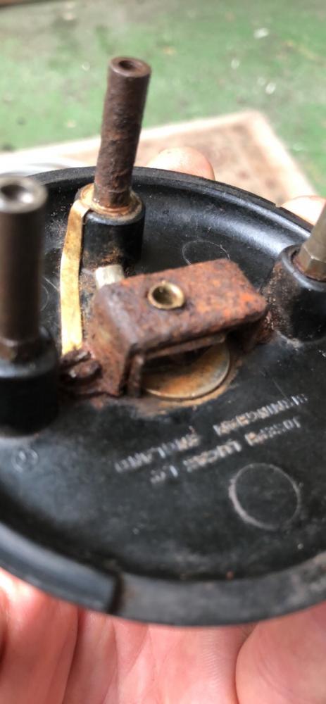

My horn switch has stopped working as it is quite badly corroded. I have good power connectivity either side of the switch so I know this is my problem. Does anyone have a replacement please or knows of an alternative switch that will do the job? My switch is from a Ruby/Opal/Pearl.

Hi Matt, Looking at the photo although rusted and corroded is looks reasonably sound. Is it possible to clean up the electrical connections to make it work again.

If you don't already have one, I have this one which I have no plans for... It may clean up ok.
