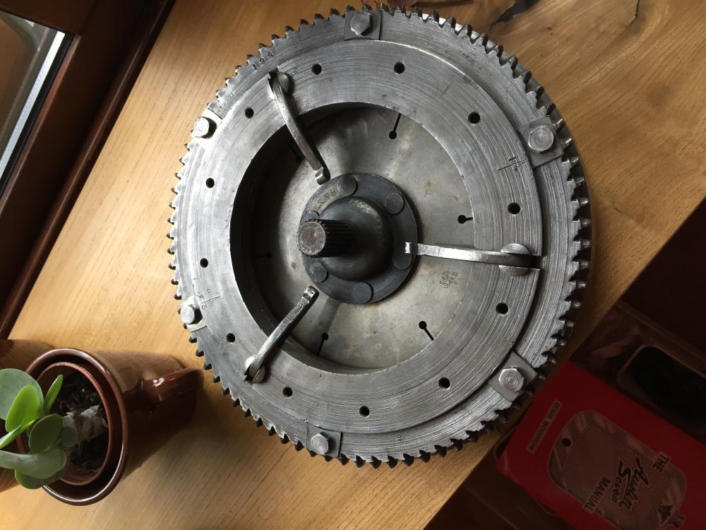

Another dreich day in Borderland. The clutch
And flywheel in this car both had factory marks
Indicating 1:4 and 2:3 so re-aligned them to those marks.
Neil is making an alignment tool to centre
the splined shaft of the clutch plate so not fully bolted
up yet with the tab washers, plus still to double check
The lever positions so may need more attention.
