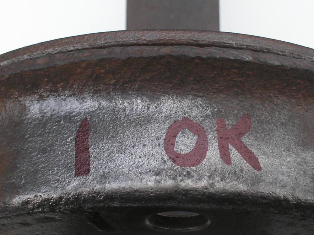

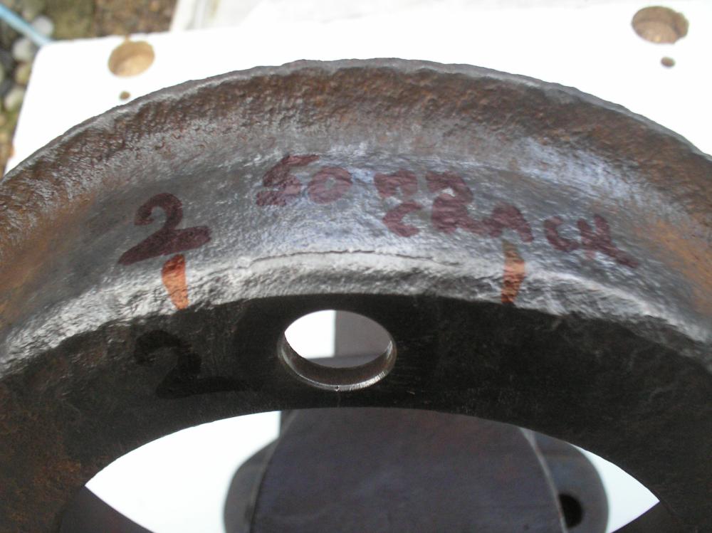

Brake drums from the rear of a 2CV van I rebuilt
I was Horrified what could have happened when they join up.
